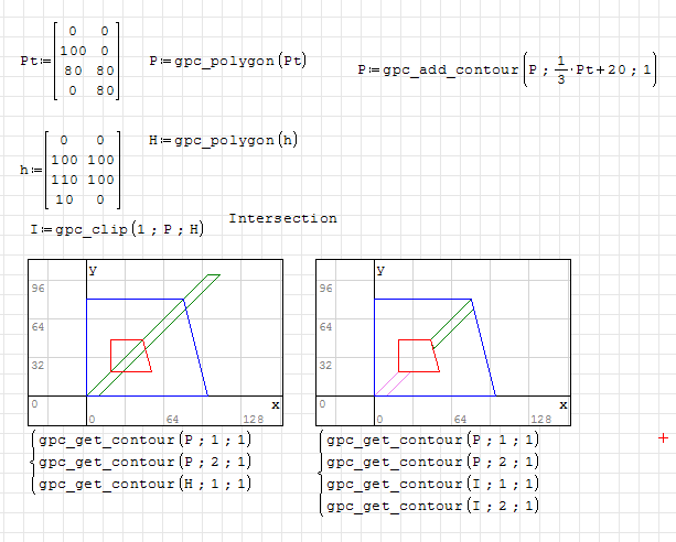

In regards to hatch and fill - do we have a Smath code that can hatch a closed polygon?

#31 Опубликовано: 29.03.2017 08:59:12
Hello Alex,
We don't have it yet for the closed polygon.
Try the gpc wrapper plugin by davide
GPC.sm (6,8 КиБ) скачан 1892 раз(а).
