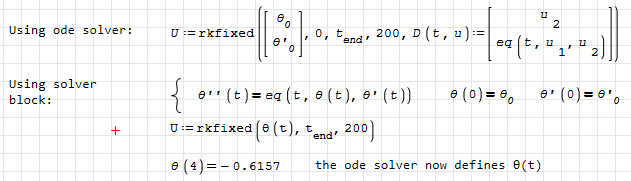

SMath Forum SMath Studio Samples Double pendulum model and animation 2 Pages (22 items) Previous 1 2 Double pendulum model and animation - Is the model correct? - Messages Go to last post #21 Posted: 2025/11/6 15:38:47 Alvaro 1,123 likes in 1,795 posts. Group: User Hi. Here it is.SimplePendulumLagrangian.sm (87.38 KiB) downloaded 816 time(s).Best regards.Alvaro. #22 Posted: 2025/11/6 22:41:17 Alvaro 1,123 likes in 1,795 posts. Group: User Hi. I added the method of using the solver block for the simple pendulum problem. It's always good to have more than one method for solving things.SimplePendulumLagrangian.sm (90.39 KiB) downloaded 816 time(s).Best regards.Alvaro. 2 Pages (22 items) Previous 1 2 New Posts No New Posts
