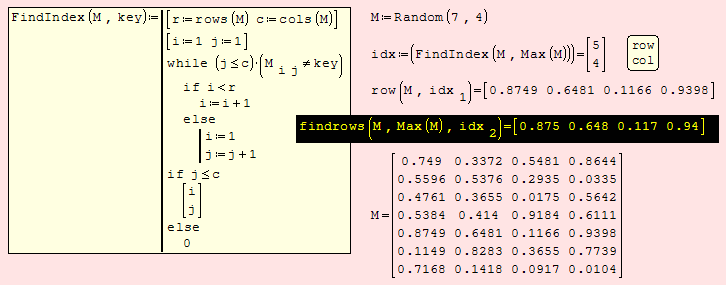

findrows from Smath menu f(x) may just be what you need.
Truncate the matrix/vector to avoid residuals smaller than 10^-15
For more complicated investigation, visit Samples Find Index
posted few days ago ... lot more involved.
Cheers ... Jean.
#6 Posted: 2022/10/14 09:12:57
findrows has limited use unless for specific end use wrt Bolean '0'
For long square/rectangular matrix, better use the assisted code.

#8 Posted: 2022/10/26 16:26:45
Oscar Campo
Oscar Campo
135 likes in 309 posts.
match.sm (11.95 KiB) downloaded 1015 time(s).
Some good improvements suggested by Razonar: versions of match() function
