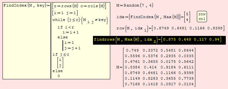

#5 Опубликовано: 13.10.2022 22:04:54
Can I access this function ?
findrows from Smath menu f(x) may just be what you need.
Truncate the matrix/vector to avoid residuals smaller than 10^-15
For more complicated investigation, visit Samples Find Index
posted few days ago ... lot more involved.
Cheers ... Jean.
#6 Опубликовано: 14.10.2022 09:12:57
findrows has limited use unless for specific end use wrt Bolean '0'
For long square/rectangular matrix, better use the assisted code.

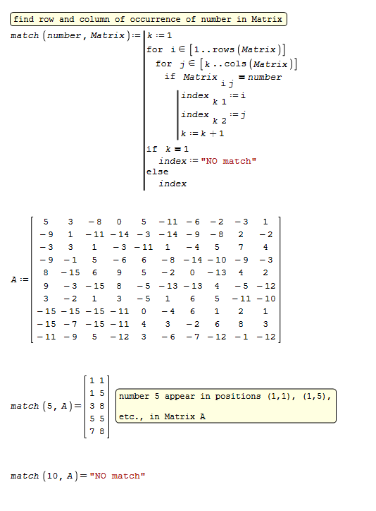

#7 Опубликовано: 25.10.2022 11:41:36
Oscar Campo
Oscar Campo
Hello, I'm searching for some function like match(z, A)(Looks in a vector or matrix, A, for a given value, z, and returns the index (indices) of its positions in A) in Mathcad.
I will appreciate any kind of help.
match.sm (11,95 КиБ) скачан 1745 раз(а).
Alvaro 26.10.2022 14:46:00
#8 Опубликовано: 26.10.2022 16:26:45
Oscar Campo
Oscar Campo
Some good improvements suggested by Razonar: versions of match() function
Alvaro 26.10.2022 18:07:00
