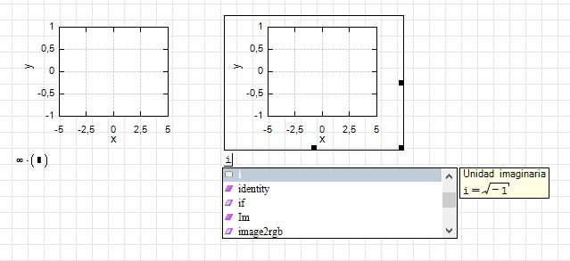

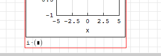

When I try to type i(t) I get i*(t), automaticaly. Why?

#3 Posted: 2018/10/4 01:07:27
1,123 likes in 1,795 posts.
Basile
Hi Basile. Remember that i isn't unfortunately like other variables, and it is reserved for the imaginary unit (In mathcad it is 1i or 1j, much better than the SMath convention). Probably the problem is related with this, because you can see the same behavior with the infinity symbol (Ctrl-z).

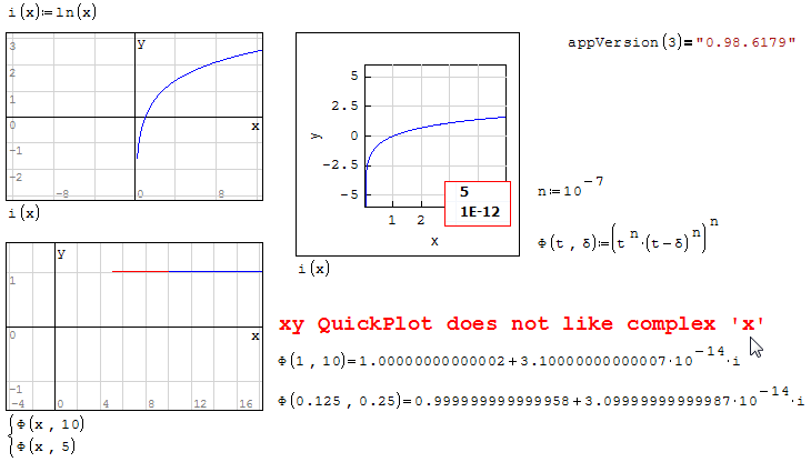

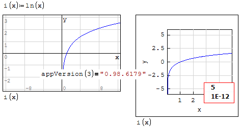

The problem is within version(s) past 6179.
#5 Posted: 2018/10/4 11:38:31
1,554 likes in 1,864 posts.
This is a feature of the program, not a plugin.
#6 Posted: 2018/10/4 21:44:46
Basile,
Can you plot or not ? That is the question.
If NOT: a damned bug or missing link.
Certainly not a feature. That 'i' imaginary freaks an indexed
for loop still exists in 6179 ... index 'ii' or else.

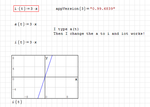

#7 Posted: 2018/10/27 22:48:14
Basile
Basile
8 likes in 172 posts.
Hello to All,
This is my solution:
Basile
