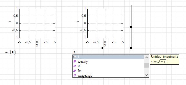

When I try to type i(t) I get i*(t), automaticaly. Why?
Thank you,
Basile

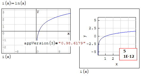

#2 Опубликовано: 03.10.2018 23:26:11
When I try to type i(t) I get i*(t), automatically. Why ?
That can't be. Type i(x)
The canvas variable is 'x' ... NOT 't'

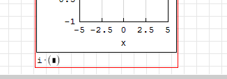

#3 Опубликовано: 04.10.2018 01:07:27
1 125 сообщений из 1 798 понравились пользователям.
Basile
Hi Basile. Remember that i isn't unfortunately like other variables, and it is reserved for the imaginary unit (In mathcad it is 1i or 1j, much better than the SMath convention). Probably the problem is related with this, because you can see the same behavior with the infinity symbol (Ctrl-z).

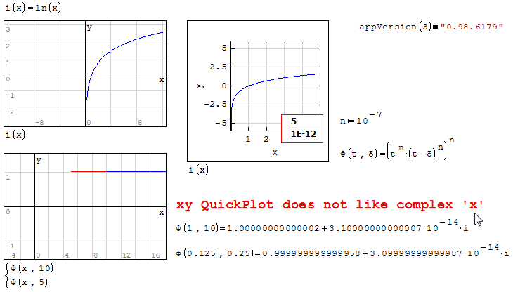

#6 Опубликовано: 04.10.2018 21:44:46
Basile,
Can you plot or not ? That is the question.
If NOT: a damned bug or missing link.
Certainly not a feature. That 'i' imaginary freaks an indexed
for loop still exists in 6179 ... index 'ii' or else.

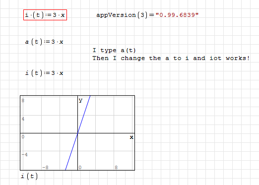

#7 Опубликовано: 27.10.2018 22:48:14
Basile
Basile
8 сообщений из 172 понравились пользователям.
Hello to All,
This is my solution:
Basile
