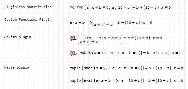

How to make this in Smath:
Mathcad Prime approach:
How is it done this in Smath?
#2 Posted: 2024/10/4 19:38:18
1,554 likes in 1,864 posts.
maple-subs.sm (2.94 KiB) downloaded 1406 time(s).
Links:
1. Maple Tools
2. substitute subexpressions into an expression (maplesoft support)

Ok, understood.
As curiosity, do you know if maxima engine/plugin has such type of commands: simplify, substitute? Or this things are possible only through maple engine (which this engine maple has these commands)?
#4 Posted: 2024/10/5 00:34:45
1,123 likes in 1,795 posts.
subs.sm (9.76 KiB) downloaded 1406 time(s).
