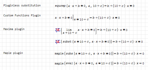

#4 Posted: 10/5/2024 12:34:45 AM
1,139 likes in 1,805 posts.
subs.sm (9.76 KiB) downloaded 1610 time(s).
