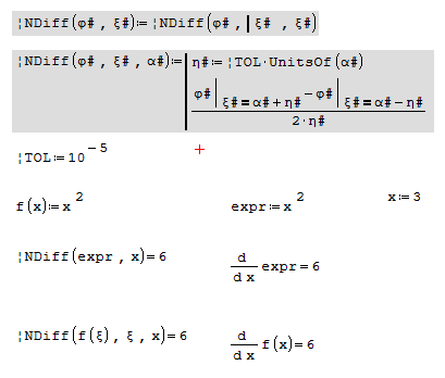

Arie

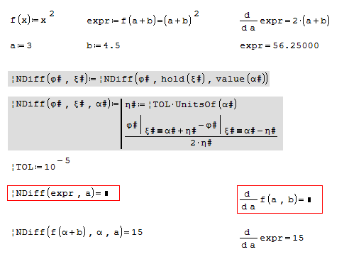

Hi. Thanks for the tip. But isn't enough for somethings more or less basics tasks, like call NDiff with 2 args, and not 3. Also, there are something else wrong about diff and how it handle some cases.
The problem with your two argument function is that you're using hold() and value() functions in function call and those functions aren't defined anywhere.
The method still works with your defined functions IFF you define a and b when you would normally call eval()
You could also use the method Jean suggests, by calling
clear(a,b)
. Only you would then have to redefine a and b when you want to evaluate.
uneval (3).sm (10.68 KiB) downloaded 1422 time(s).

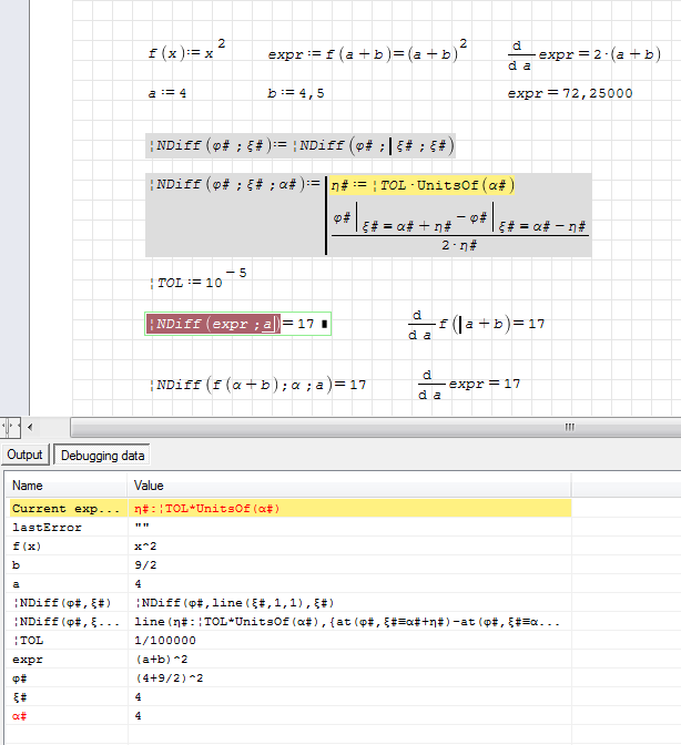

#10 Posted: 2018/2/2 17:23:24
1,355 likes in 2,271 posts.
Isn't this pretty much what you want? Magics of the line operator.
uneval_Kr.sm (8.6 KiB) downloaded 1410 time(s).

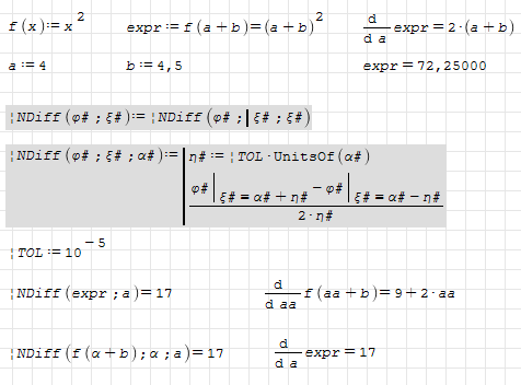

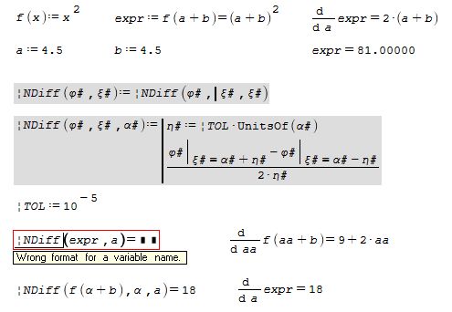

I forgot this one:
Arie 2018/2/2 17:27:00
#11 Posted: 2018/2/2 17:57:16

#12 Posted: 2018/2/2 18:03:17
Thanks Martin!
I learned something new today. Looking forward to trying some more of these tricks with line operators in my own applications.
I wish I could explain this.
The debugger doesn't seem to reveal the secret:

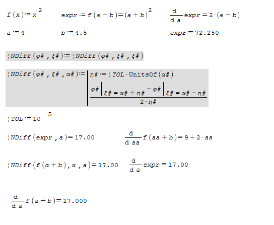

frapuano 2018/2/2 18:23:00, Alvaro 2018/2/2 21:07:00

#15 Posted: 2018/2/3 00:08:01
The line is a local definition operator.
Observe the red example: coefficients 'a' exist/defined/assigned
thus satisfy the Σ . On the other example |Σ 'c' result from calculations.
The summing operator must "steal" the 'c' via the isolating local line operator.
Differently but of same nature, DeBoor is redefined locally on the RHS.
More examples have been encountered [there was Legendre polynomials...]
#16 Posted: 2018/2/4 07:08:19
1,123 likes in 1,795 posts.

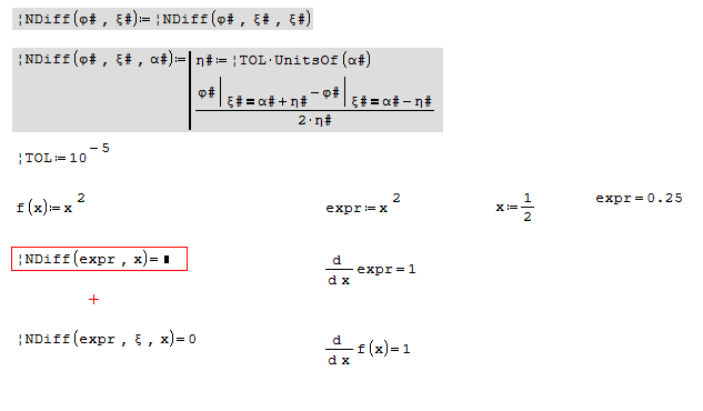

Hi. The proposed method looks excellent, but only works for integers.
So, it's a bug or what else?
#17 Posted: 2018/2/4 08:47:22
The at() function used for applying the perturbation makes a search and replace without limiting the search expression to valid variable names. It can't, however, handle expressions as replacement targets.
The line function isn't at stake here.
Alvaro 2018/2/5 18:35:00

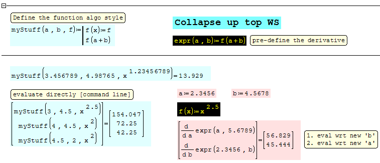

Maybe I don't understand what you are attempting,
if so => here is simple procedure that needs no
Uneval/re-eavl ... it just works on demand ,
wherever demanded in the work sheet.
Maths Uneval.sm (7.66 KiB) downloaded 1411 time(s).
