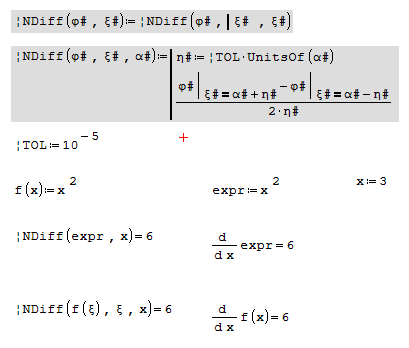

Hi.
An uneval ability, like 'x' and x::uneval in maple, or Mathematica's Hold .
Thanks for this wonderful tool that is SMath.

Hi. Thanks for the tip. But isn't enough for somethings more or less basics tasks, like call NDiff with 2 args, and not 3. Also, there are something else wrong about diff and how it handle some cases.
uneval.sm (8.16 KiB) downloaded 1629 time(s).

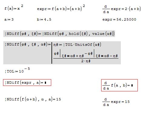

The problem with your two argument function is that you're using hold() and value() functions in function call and those functions aren't defined anywhere.
The method still works with your defined functions IFF you define a and b when you would normally call eval()
You could also use the method Jean suggests, by calling
clear(a,b)
. Only you would then have to redefine a and b when you want to evaluate.

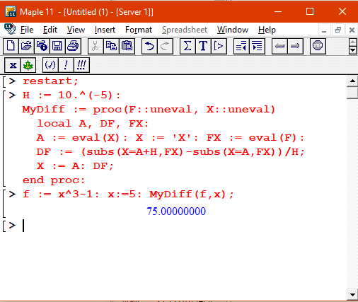

#9 Posted: 2/2/2018 4:57:26 PM
1,134 likes in 1,805 posts.
uneval (3).sm (10.68 KiB) downloaded 1584 time(s).
Sure, I'm requesting them.
You could also use the method Jean suggests, by calling ...
Jean's method is close, but not enough (actually it's equivalent to x='x' in the image). Can you replicate this Maple's code in SMath?

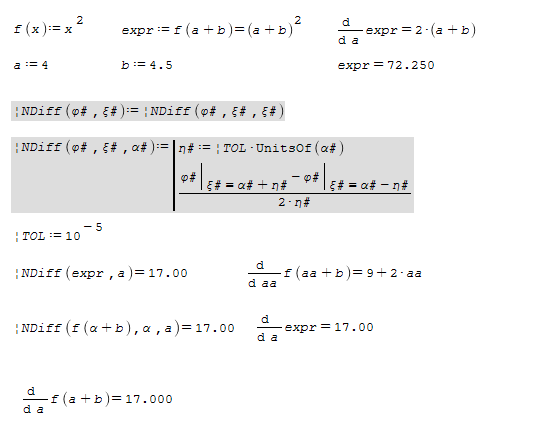

#10 Posted: 2/2/2018 5:23:24 PM
1,359 likes in 2,273 posts.
Isn't this pretty much what you want? Magics of the line operator.
uneval_Kr.sm (8.6 KiB) downloaded 1573 time(s).

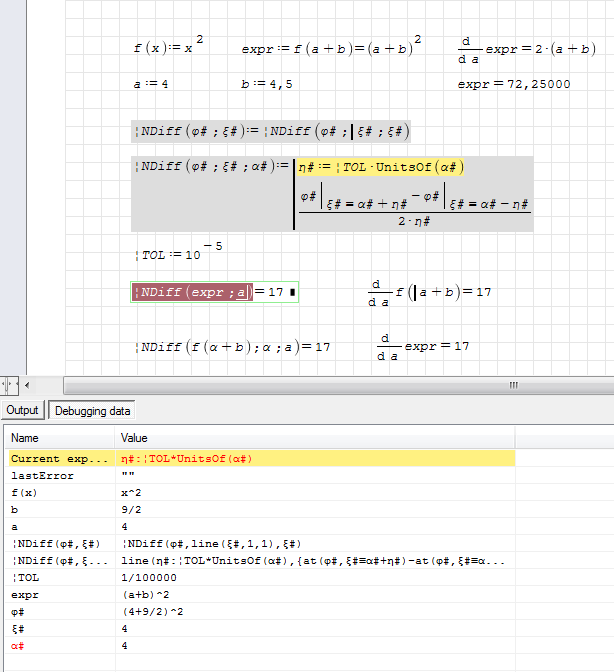

I forgot this one:

#12 Posted: 2/2/2018 6:03:17 PM
Thanks Martin!
I learned something new today. Looking forward to trying some more of these tricks with line operators in my own applications.
I wish I could explain this.
The debugger doesn't seem to reveal the secret:
frapuano 2/2/2018 6:23:00 PM, Alvaro 2/2/2018 9:07:00 PM

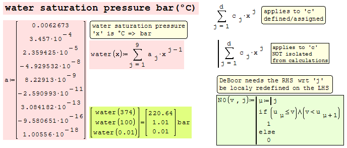

#15 Posted: 2/3/2018 12:08:01 AM
The line is a local definition operator.
Observe the red example: coefficients 'a' exist/defined/assigned
thus satisfy the Σ . On the other example |Σ 'c' result from calculations.
The summing operator must "steal" the 'c' via the isolating local line operator.
Differently but of same nature, DeBoor is redefined locally on the RHS.
More examples have been encountered [there was Legendre polynomials...]

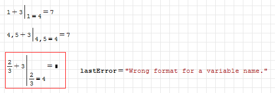

#16 Posted: 2/4/2018 7:08:19 AM

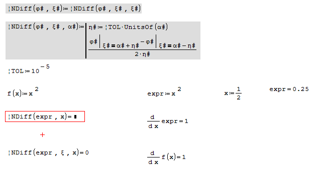

Hi. The proposed method looks excellent, but only works for integers.
So, it's a bug or what else?
#17 Posted: 2/4/2018 8:47:22 AM

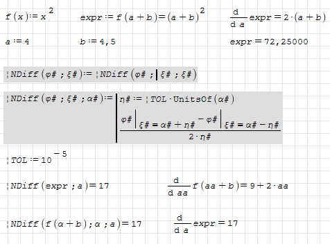

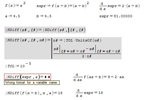

The at() function used for applying the perturbation makes a search and replace without limiting the search expression to valid variable names. It can't, however, handle expressions as replacement targets.
The line function isn't at stake here.
Alvaro 2/5/2018 6:35:00 PM
#18 Posted: 2/4/2018 10:18:55 AM
More generally, the line operator is the program operator.
It may be as short as one element. Attached are three typical
applications. DeBoor is just demo, here [attached separately].
Maths Local Definition.sm (28.24 KiB) downloaded 1615 time(s).
Spline De Boor [Colibri].sm (33.42 KiB) downloaded 1428 time(s).

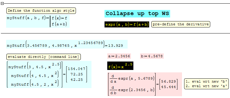

Maybe I don't understand what you are attempting,
if so => here is simple procedure that needs no
Uneval/re-eavl ... it just works on demand ,
wherever demanded in the work sheet.
Maths Uneval.sm (7.66 KiB) downloaded 1568 time(s).
