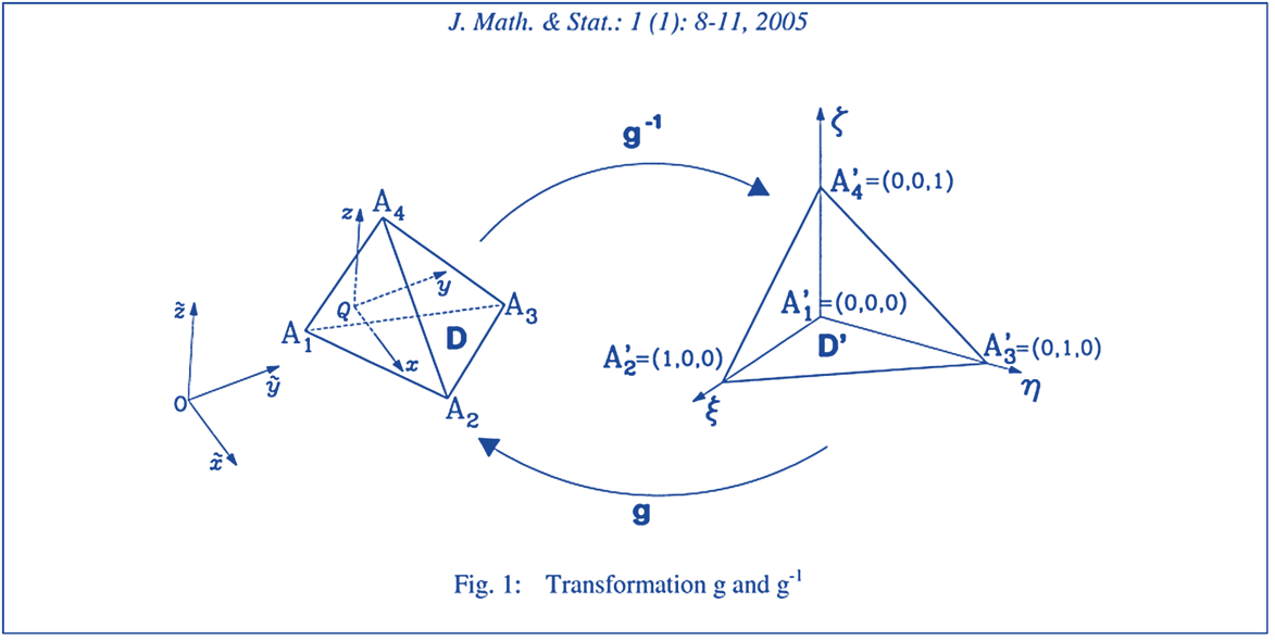

I found a very interesting paper about the explicit formulas for the inertia tensor of a tetrahedron, defined with the 3 coordinates of its 4 vertices:
https://thescipub.com/abstract/jmssp.2005.8.11
The symbolic integration process for the obtention of the inertia tensor’s terms was conducted in the “F. Tonon’s” paper by using the “Mathematica” program.
I used the “SMath’ Maxima plugin” for the symbolic integrations.
My results gave identical numerical results as that of the “F. Tonon’s” example.

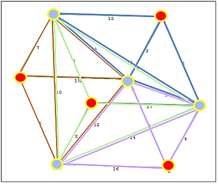

I thought on another nice issues for using tetrahedrons, based on the decomposition of an irregular hexahedron into four linked tetrahedrons as here:
In such way we can create a sort of super element, with an unique output insted of four and also with only 24 input coordinates instead of 6*4*3=72.
The hexahedron finite element is often prefered.

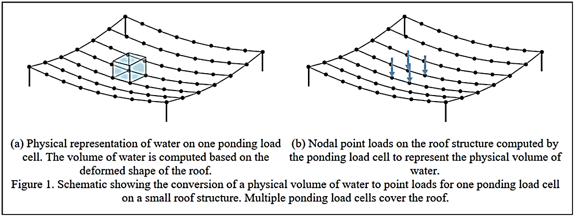

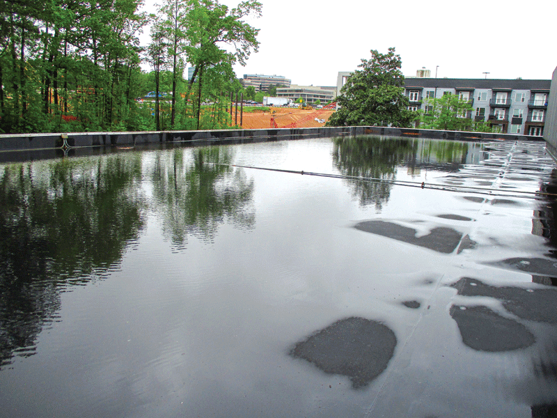

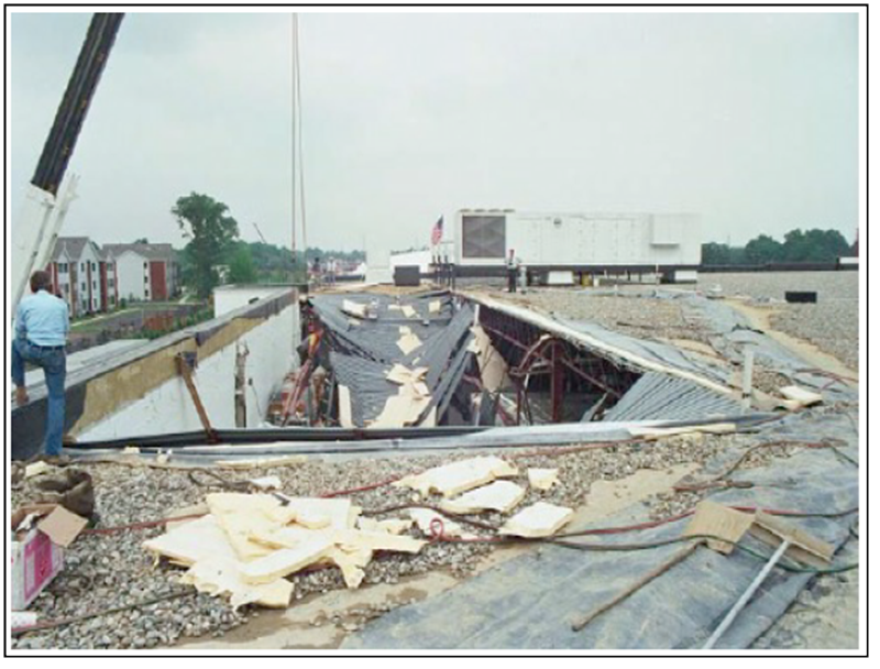

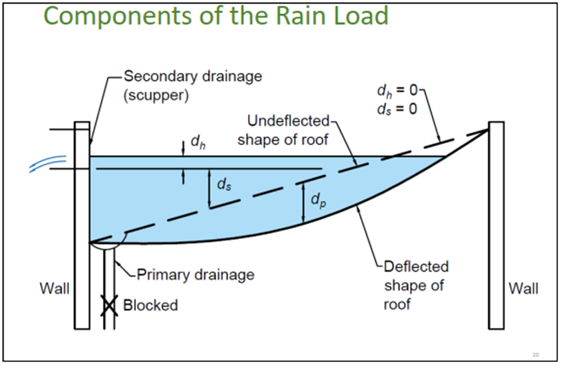

My starting point on this topic was not mainly the Finite Elements, but a problem about the analysis of the "Water ponding on contructions roofs". This problem contains some geometrical nonlinear aspects.
The geometrical properties of 3D objects are widely used also in many other fields ...
