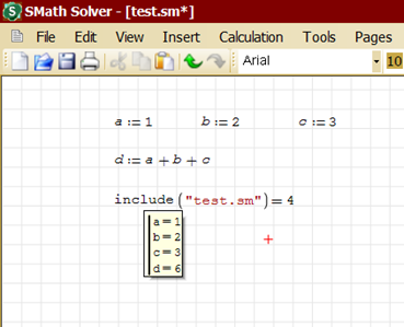

Hi. I think what the user request is a function similar to "clear all" in Matlab.
Given that include is capable of collecting all the names of the variables of a worksheet as the "whos" command of Matlab would do, perhaps the include code can be used to implement the option to delete all the variables with Clear( "all" ) or something similar.

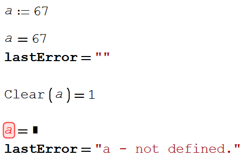

is there any function to remove all declared variables? similar to Clear
Clear(■,■,■,■,■) ...
clears the system in cause [variables, vectors, matrices]
Clear(x,y,z,m,ω)=1 are evaporated from the system.
