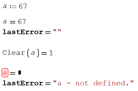

remove all declared variables - is there any function to remove all declared variables? similar to clear - Сообщения
WroteHelp!
You can install the "Special Functions" plugin, which has a Clear() function as you need.
that would be an answer for your request.
But it does not, so this is a dead-end.
For now, you have to make all your variables an element of vector/matrix,
if you want to clear all of them in single command.
Or manually clear them one by one.

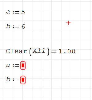

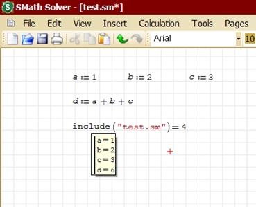

Hi. I think what the user request is a function similar to "clear all" in Matlab.
Given that include is capable of collecting all the names of the variables of a worksheet as the "whos" command of Matlab would do, perhaps the include code can be used to implement the option to delete all the variables with Clear( "all" ) or something similar.
Wroteis there any function to remove all declared variables? similar to Clear
Clear(■,■,■,■,■) ...
clears the system in cause [variables, vectors, matrices]
Clear(x,y,z,m,ω)=1 are evaporated from the system.
Page17 Clear.sm (15,52 КиБ) скачан 1597 раз(а).

WroteHi. I think what the user request is a function similar to "clear all" in Matlab.
Yes Razonar, probably that is the OP's request.
He doesn't want to write every variable into Clear().
Just Clear(ALL) and puff, all defined shall be cleared.

AFAIK, there is no Clear(All) ... what is All ?
Clear(,,,) also restores the built-in.
Cheers ... Jean.
Maths Clear Restore.sm (9,14 КиБ) скачан 1399 раз(а).

WroteSo there is a Clear(All) function?
There is not a Clear(All) function.
No method is applicable to remove all variables at once.
Wroteis there any update on such a "Clear(All)" function?
There is not an update, yet.
Unfortunately, I guess none shall appear on horizon soon.
Thanks for the beta update.
What would you think about revising output string?
Instead of "1", it can be;
arg==1 --> "All cleared"
arg==2 --> "Variables cleared"
arg==3 --> "Functions cleared"
WroteThis works!!!
You're welcome, glad it seems to work correctly on first try. I still have to check carefully the (2)nd option, since as it is now it deletes "anything that is not a function" (including some low-level stuff).
