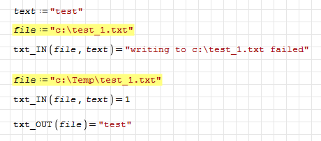

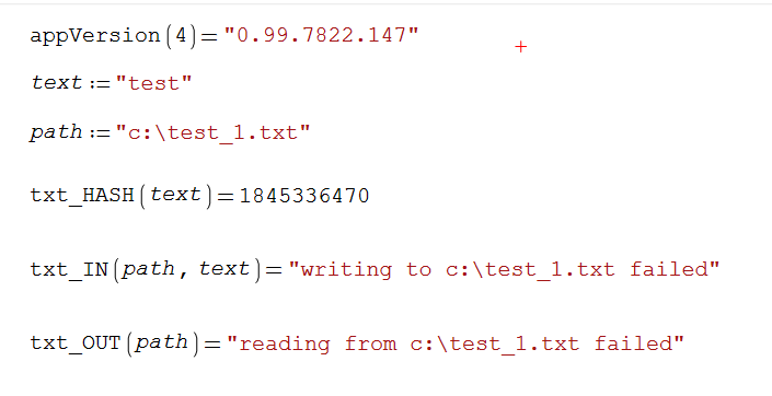

It seems that there is a problem with this plugin:
I'm working on SMath Studio 0.997822

Sorry... I updated the plugin, but it seems that the problem continues:
#6 Posted: 2021/7/10 12:03:41
1,554 likes in 1,864 posts.
Try a different folder. Writing to the root folder is prohibited.

Thanks, UNI! the little details make the big differences!
