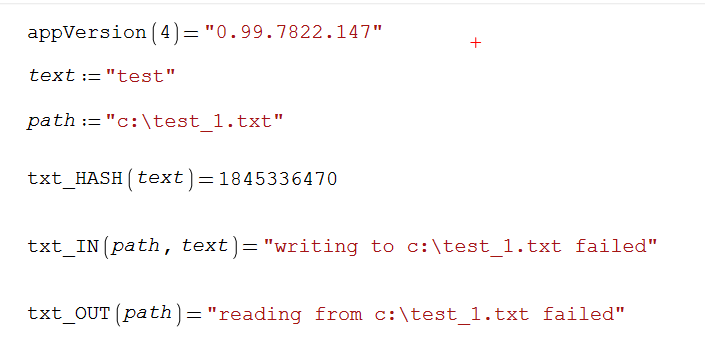

It seems that there is a problem with this plugin:
I'm working on SMath Studio 0.997822

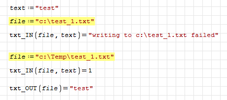

#6 Опубликовано: 10.07.2021 12:03:41
Try a different folder. Writing to the root folder is prohibited.

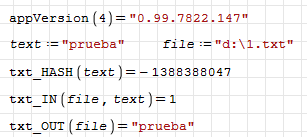

#7 Опубликовано: 10.07.2021 12:32:16
Oscar Campo
Oscar Campo
Thanks, UNI! the little details make the big differences!
