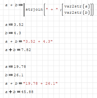

Not how you wanted in single line but possible.

Just my decimal values get displayed as fractions
Evaluate Numeric.
#5 Posted: 2021/10/23 15:39:21
598 likes in 1,380 posts.
Thks a lot, it will do.
a := 3.5
b := 4.5
a + b = 7/2 + 9/2
You can write variables inside simple functions with this method.
This is not a practical way to write variables inside complex functions.
And it does not look good too. Yet it is better than nothing.
You can write a + b with Ctrl+Shift+K.

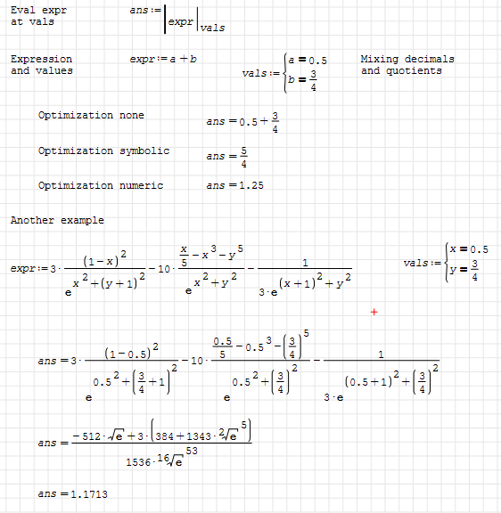

Hi. This is another way.
intermediate_results.sm (14.4 KiB) downloaded 1066 time(s).
sergio 2021/10/24 16:26:00
That looks exactly as I was looking for ... going to study it. Thks a lot, it will save me quite a bit of time.

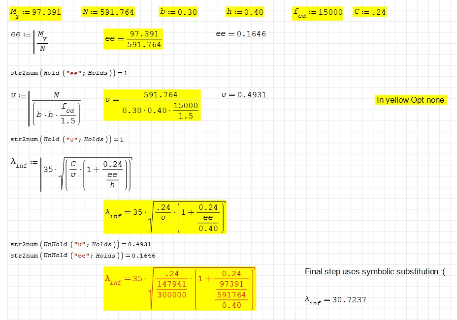

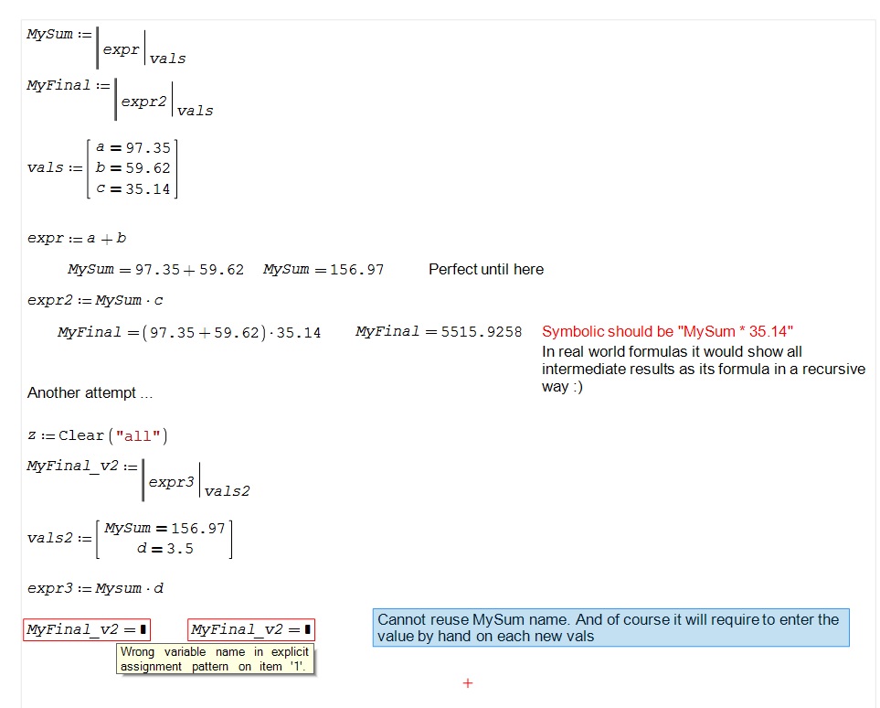

Hi Razonar,
it works perfectly well for initial formulas, but cannot find any way to use a previous result on a new one.
Cannot put all values in a single vals, the simbolic substitution will show in the second formula the formula (not the value) of the calculated value (ee).
Cannot either reuse names.
Any idea?

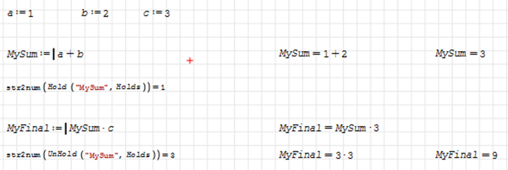

#9 Posted: 2021/10/24 22:10:44
Any idea?
I have an idea, if someone has better you can use it.
Rewrite expressions and hide them inside areas.
Configure page setup with "no areas".
When you save as pdf or print, it will show as continuous.
MySum.sm (8.16 KiB) downloaded 1064 time(s).
But here is a humble suggestion.
SMath was not coded with intent to show intermediate results.
You are going to struggle very much with this approach.

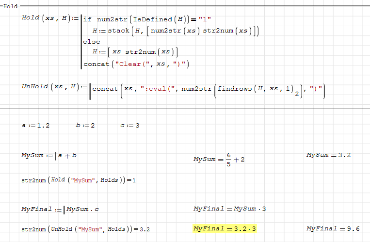

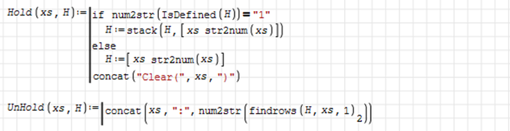

Hi. This is another way. The feature request actually is here.
Using
You can get
Hold.sm (9.78 KiB) downloaded 1059 time(s).
or
Hold_v2.sm (9.06 KiB) downloaded 1060 time(s).
sergio 2021/10/25 14:18:00

Too easy to be true Final step uses fractions to substitute ... Use a:=1.2 in your example and you will see.
Actual formulas are for sure more complex so the data display is really confusing.
#13 Posted: 2021/10/25 21:06:10
1,123 likes in 1,795 posts.
Hi. Insert eval( ) in UnHold

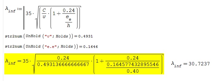

You are a genious. Thks!
Just trying to figure out how to avoid too many decimals now
Decimal places set to 4 everywhere
#15 Posted: 2021/10/26 12:21:13
Hi. Thanks! ... but ... not ... but thanks. That behavior seems to be a bug or an oversight: set the decimal places in the output of an expression with None Optimization.
In the meantime, this could be a workaround, but could be dangerous, because change the stored value. Actually I don't really recommend it.
#16 Posted: 2021/10/26 14:01:06
DeepButi
DeepButi
0 likes in 7 posts.
Ok, ok. Really it's a BIG THANKS.
:round(eval(... works perfectly well
:eval(round(... didn't.
