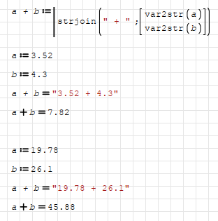

#6 Posted: 10/23/2021 4:29:43 PM
1,139 likes in 1,805 posts.
Hi. This is another way.
intermediate_results.sm (14.4 KiB) downloaded 1229 time(s).
sergio 10/24/2021 4:26:00 PM

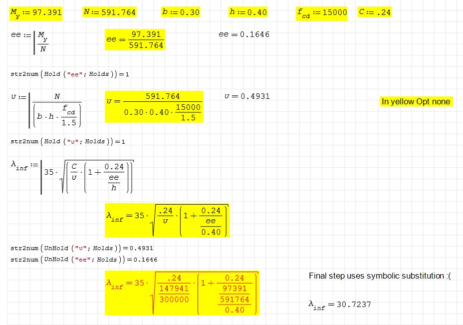

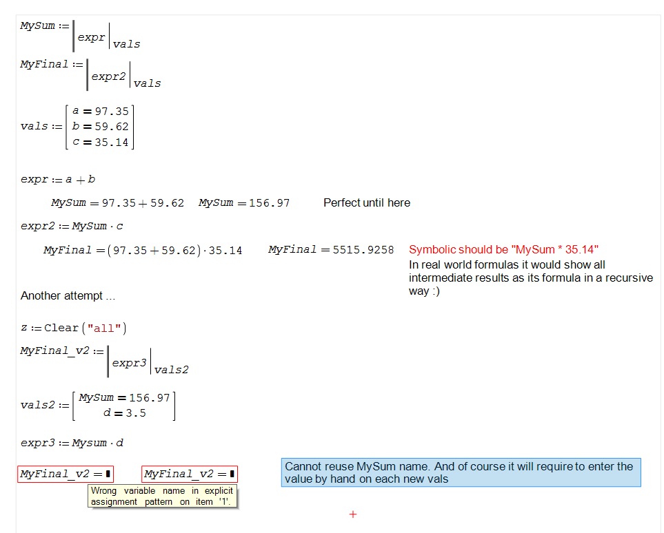

Hi Razonar,
it works perfectly well for initial formulas, but cannot find any way to use a previous result on a new one.
Cannot put all values in a single vals, the simbolic substitution will show in the second formula the formula (not the value) of the calculated value (ee).
Cannot either reuse names.
Any idea?

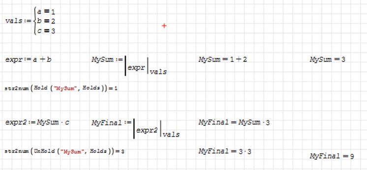

#9 Posted: 10/24/2021 10:10:44 PM
600 likes in 1,381 posts.
Any idea?
I have an idea, if someone has better you can use it.
Rewrite expressions and hide them inside areas.
Configure page setup with "no areas".
When you save as pdf or print, it will show as continuous.
MySum.sm (8.16 KiB) downloaded 1216 time(s).

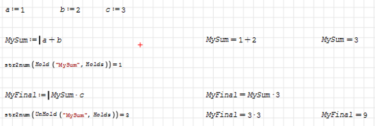

#11 Posted: 10/25/2021 1:29:52 PM

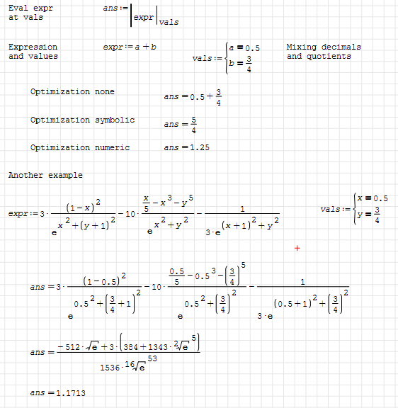

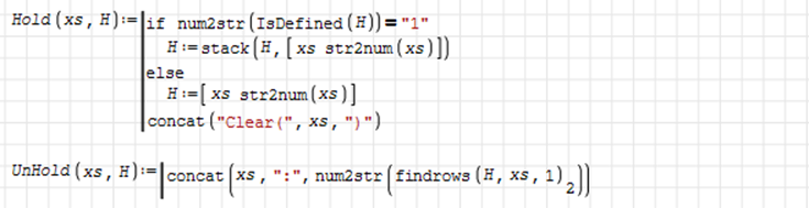

Hi. This is another way. The feature request actually is here.
Using
You can get
Hold.sm (9.78 KiB) downloaded 1218 time(s).
or
Hold_v2.sm (9.06 KiB) downloaded 1215 time(s).
sergio 10/25/2021 2:18:00 PM

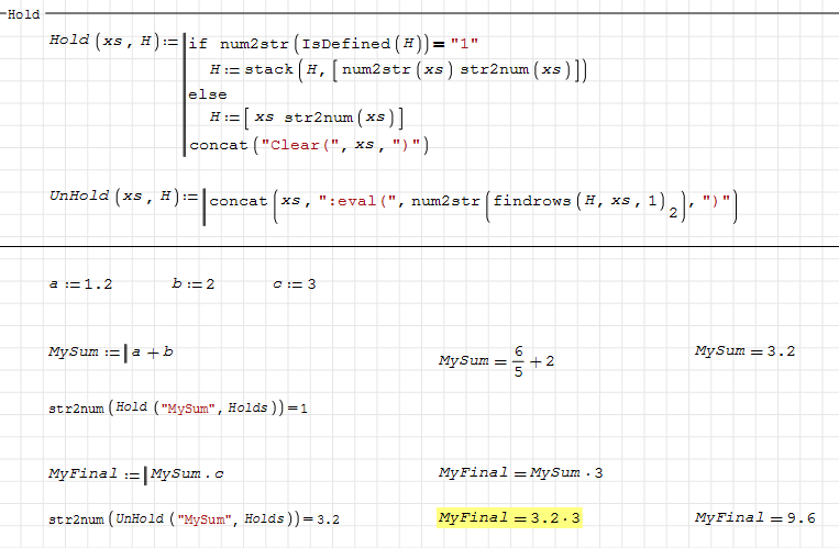

#12 Posted: 10/25/2021 6:31:25 PM
DeepButi
DeepButi
0 likes in 7 posts.
Too easy to be true Final step uses fractions to substitute ... Use a:=1.2 in your example and you will see.
Actual formulas are for sure more complex so the data display is really confusing.
#13 Posted: 10/25/2021 9:06:10 PM
Hi. Insert eval( ) in UnHold
#14 Posted: 10/26/2021 5:48:01 AM
DeepButi
DeepButi
0 likes in 7 posts.
You are a genious. Thks!

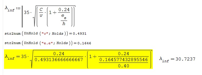

Just trying to figure out how to avoid too many decimals now
Decimal places set to 4 everywhere
#15 Posted: 10/26/2021 12:21:13 PM
Hi. Thanks! ... but ... not ... but thanks. That behavior seems to be a bug or an oversight: set the decimal places in the output of an expression with None Optimization.
In the meantime, this could be a workaround, but could be dangerous, because change the stored value. Actually I don't really recommend it.
#16 Posted: 10/26/2021 2:01:06 PM
DeepButi
DeepButi
0 likes in 7 posts.
Ok, ok. Really it's a BIG THANKS.
:round(eval(... works perfectly well
:eval(round(... didn't.
