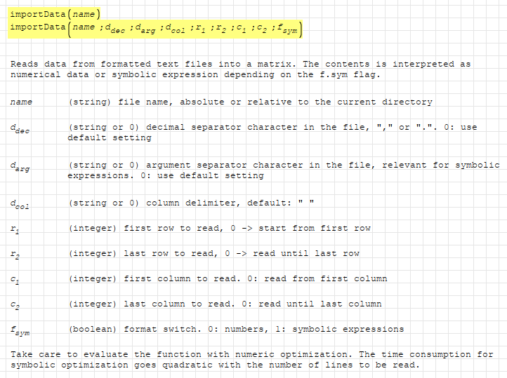

If you mean a comma separated file (csv), yes it is possible with importData().

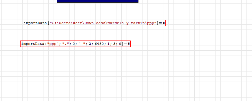

I allow your instrruccions, i dont know if i am doing ok, the name of the file is "ppp" and it shows me in the smath studio thats it is not reconized.

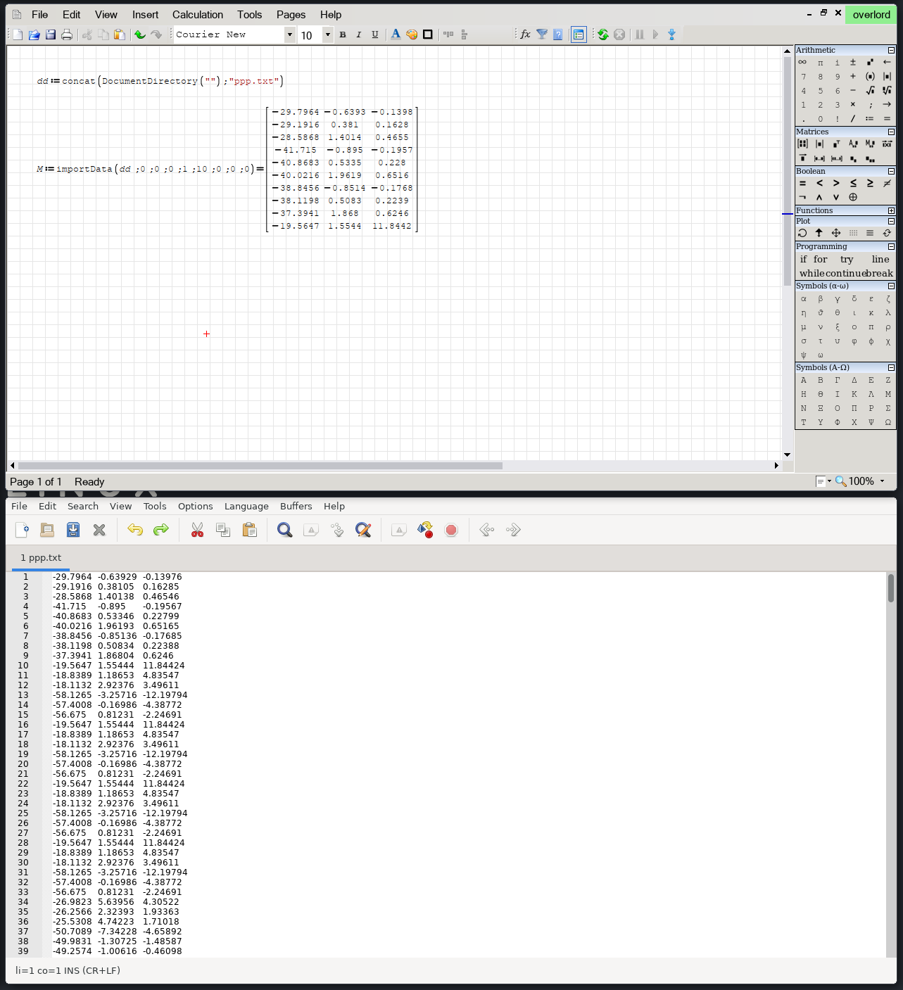

You should write "ppp.txt" where you indicate your file.
You also just have to delete the first line from your data file.
It creates conflict between your function and data.
Data it provides don't match pattern of function.
So in result data can't be read.
Check below.
Show Spoiler
PS: martin is also right about getting partial data down below.

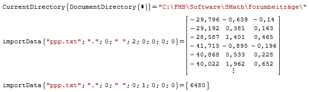

#7 Posted: 2021/6/17 17:12:18
1,308 likes in 2,221 posts.
You can access differently formatted sections by reading them separately.
import.sm (4.81 KiB) downloaded 647 time(s).
