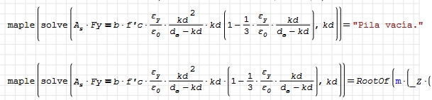

Hi everyone
I have to try to solve this equation with maple and solve but I only get the result "Empty stack", Someone knows solve it?

Hi. It seems that you put kd( ... ) instead kd*( ... ) in the maple solver.

Alvaro thanks for you answer but
"kd" is the only value unknown
#4 Posted: 2021/7/4 02:24:47
1,123 likes in 1,795 posts.
In the first expression it is kd( ... ). In the second it is kd*( ... ). There the maple answer uses RootOf, I'm guess that because you have another issue in the expression. For instance A.s*Fy have units of Newtons, but the other part not.

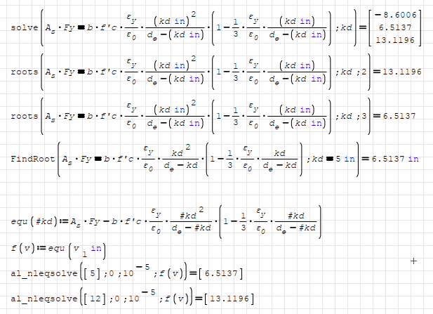

1. RootOf expands easily [Example 1]
2. root is undocumented, most precious for dual solver [Example 2]
3. allvalues ... most precious in invlaplace [Example 3]
Maple RootOf Example.sm (38.42 KiB) downloaded 1491 time(s).

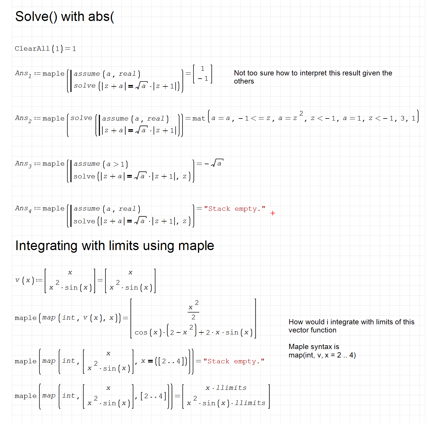

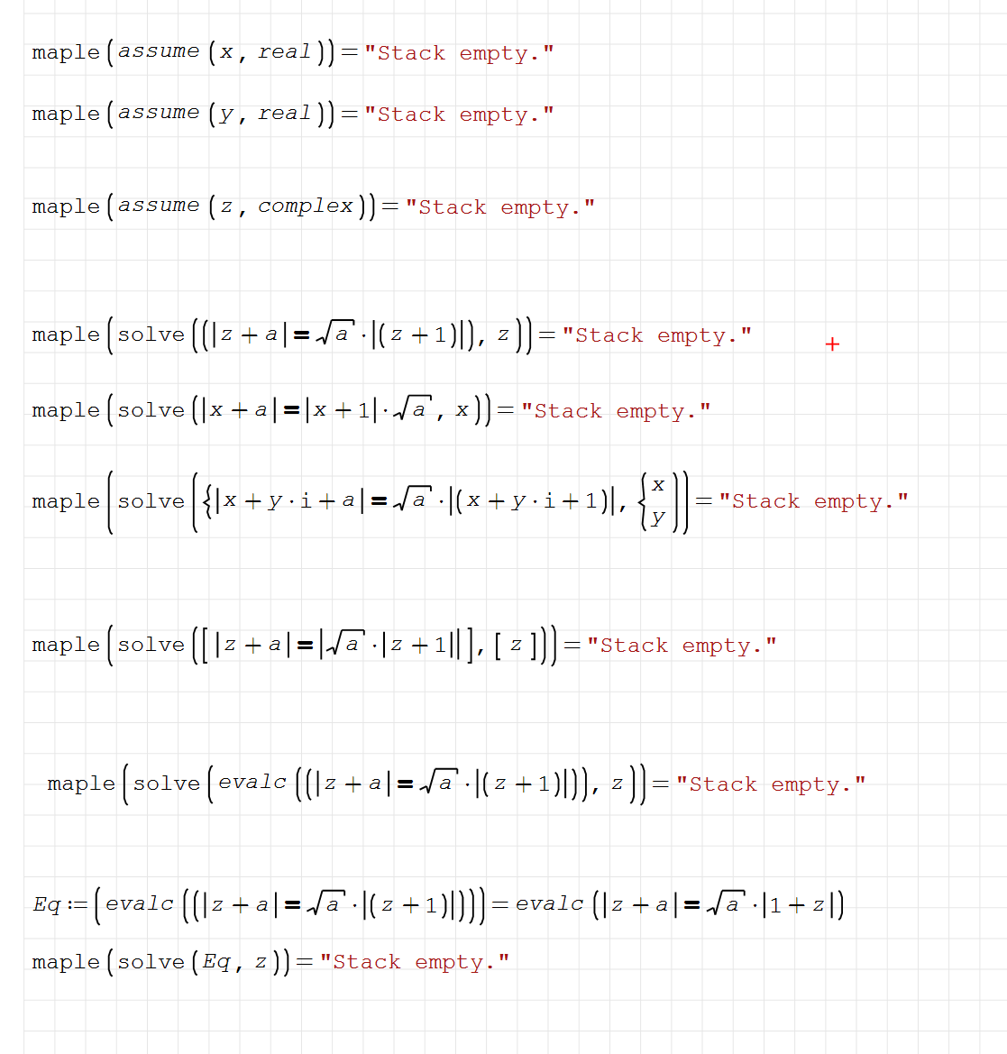

Maple Solve "stack error" when solving for complex values using abs() - Tried using the solve function using different syntax but i keep getting "stack error"
I know i could just square both side then solve, but why does this not work
any help would be apprciated

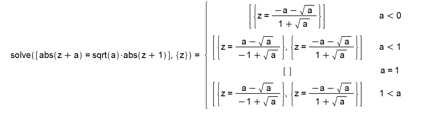

Hi. Maple's plugin isn't like Maxima's in that it doesn't "remember" previous instructions. You have to include them all in the same call.
maple assume.sm (5.36 KiB) downloaded 300 time(s).

Q1
I just found these other slightly strange results using Maple to solve that equation. I'm not too concerned with it, i just want to know what the proper way of doing this would be.
First, this version of maple is from year 2000, Therefore, many of their results will be incomplete, "primitive", or simply wrong.
Regarding Ans1, it seems to be solving the equation for a, not for z. The same goes for Ans2, but I don't really understand what kind of answer maple is giving.
Regarding Ans3, SMath simplifies the result in that way; you can see it by going to Optimization -> None
Notice that SMath's simplification rules perform the following conversion, where Maple has nothing to do with it.
Regarding Ans4, the problem becomes very difficult for this version of Maple, since the root becomes complex to a real, but negative.
Q2

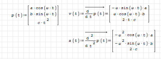

Additionally need a bit of help figuring out how to integrate with limits of a space curve. I am able to do indefinite integrals but im unsure how to do definite ones.
Use vectorize:
Q3
How would i differentiate space curves
Use vectorize:
Q4
how do i do element wise operations on matrices with maple. I know in SMath you can just use the 'vectorise' button but that does not seem to work with maple
The plugin doesn't translate SMath's vectorize function to maple, but you can use it externally, as in the integral example or this other one, where SMath doesn't know the exponential and sine integral functions, but maple does

how do i sum the values of a matrix? I tried add() and sum(), neither worked
Use sum( ... ) from SMath:

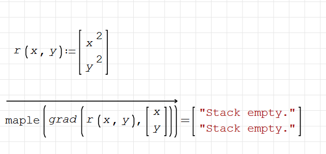

last question is just how do i take the divergance, curl or gradient of a function
thanks for all the help

Hi. Please, check some of the files in this old post:
https://smath.com/en-US/forum/topic/oSEzxZ/Grad_-Div-and-Curl-in-a-curvilinear-coordinate-system
