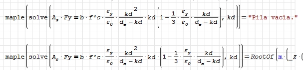

Hi everyone
I have to try to solve this equation with maple and solve but I only get the result "Empty stack", Someone knows solve it?

#2 Posted: 7/4/2021 1:41:23 AM
Hi. It seems that you put kd( ... ) instead kd*( ... ) in the maple solver.
#3 Posted: 7/4/2021 2:17:03 AM
Alvaro thanks for you answer but
"kd" is the only value unknown
#5 Posted: 7/4/2021 3:14:36 AM
Thanks a lot Alvaro

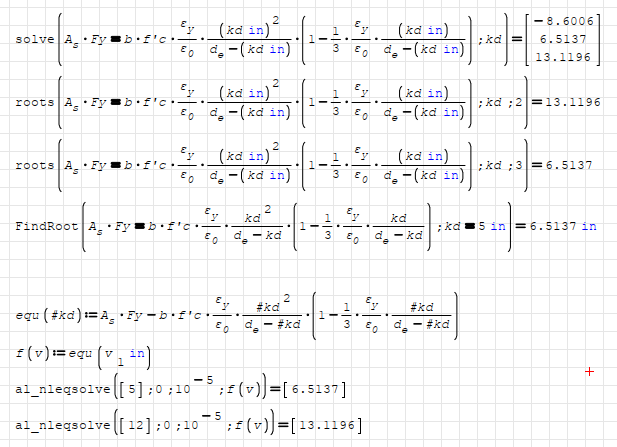

#6 Posted: 7/4/2021 9:29:55 AM
#7 Posted: 7/4/2021 12:33:54 PM
1. RootOf expands easily [Example 1]
2. root is undocumented, most precious for dual solver [Example 2]
3. allvalues ... most precious in invlaplace [Example 3]
Maple RootOf Example.sm (38.42 KiB) downloaded 1680 time(s).

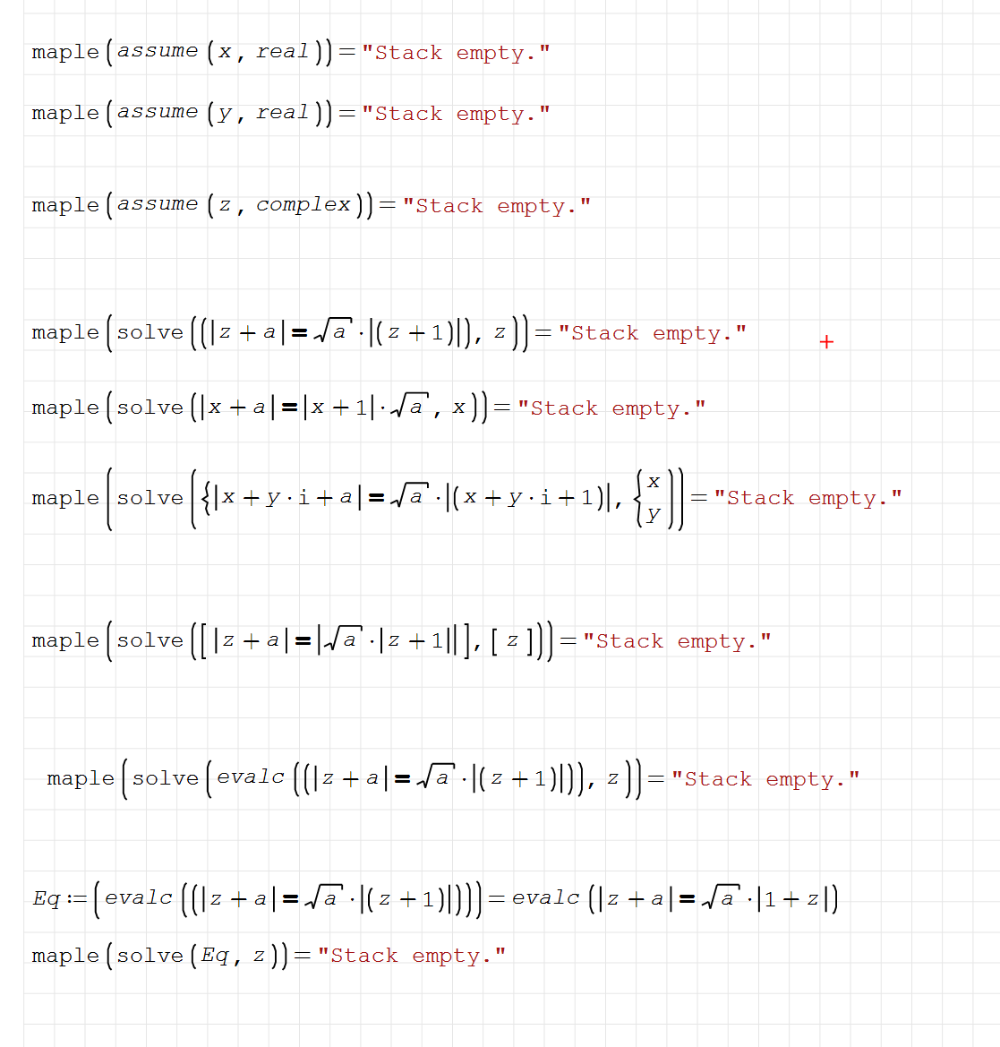

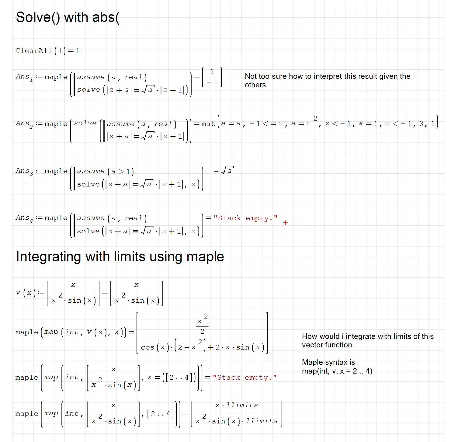

#8 Posted: 4/30/2026 12:05:40 AM
Maple Solve "stack error" when solving for complex values using abs() - Tried using the solve function using different syntax but i keep getting "stack error"
I know i could just square both side then solve, but why does this not work
any help would be apprciated
Maple Solve.sm (10.41 KiB) downloaded 479 time(s).
Maple Flow
Maple Flow
#9 Posted: 4/30/2026 6:56:05 PM
Hi. Maple's plugin isn't like Maxima's in that it doesn't "remember" previous instructions. You have to include them all in the same call.
maple assume.sm (5.36 KiB) downloaded 497 time(s).
#10 Posted: 5/1/2026 9:34:16 AM
Thank you for your help.
Im still new to SMath and Maple so i apologize if some of my questions are silly, its just hard finding resources and tutorials for using maple in SMath.
Q1
I just found these other slightly strange results using Maple to solve that equation. I'm not too concerned with it, i just want to know what the proper way of doing this would be.
Q2

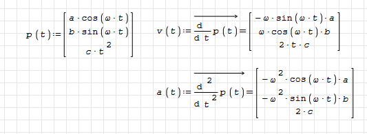

Additionally need a bit of help figuring out how to integrate with limits of a space curve. I am able to do indefinite integrals but im unsure how to do definite ones.
Q3
How would i differentiate space curves
Q4

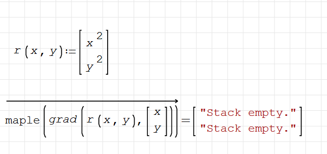

how do i do element wise operations on matrices with maple. I know in SMath you can just use the 'vectorise' button but that does not seem to work with maple
Q5
how do i sum the values of a matrix? I tried add() and sum(), neither worked
any other tips or guides for using maple in SMath would be appreciated
Q1
Q2
Q3
Q4
Q5

#11 Posted: 5/2/2026 1:50:24 AM
Hi. Happy Labor Day, Some few notes
Q1
First, this version of maple is from year 2000, Therefore, many of their results will be incomplete, "primitive", or simply wrong.
Regarding Ans1, it seems to be solving the equation for a, not for z. The same goes for Ans2, but I don't really understand what kind of answer maple is giving.
Regarding Ans3, SMath simplifies the result in that way; you can see it by going to Optimization -> None
Notice that SMath's simplification rules perform the following conversion, where Maple has nothing to do with it.
Regarding Ans4, the problem becomes very difficult for this version of Maple, since the root becomes complex to a real, but negative.
Q2
Use vectorize:
Q3
Use vectorize:
Q4
The plugin doesn't translate SMath's vectorize function to maple, but you can use it externally, as in the integral example or this other one, where SMath doesn't know the exponential and sine integral functions, but maple does
Q5
Use sum( ... ) from SMath:
You can see the first page and subsequent pages of the plugin, where the author usually provides the most relevant examples of how to use it and what he created it for.
Q1
Q2
Use vectorize:
Q3
Use vectorize:
Q4
Q5
Edited 5/2/2026 2:10:16 AM
