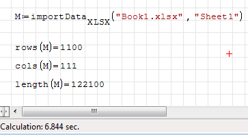

How much slow? With importData.XLSX I can import a 1100x111 matrix of numbers in ~7-8 seconds (optimization: numeric)
The code is the same:
