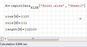

How much slow? With importData.XLSX I can import a 1100x111 matrix of numbers in ~7-8 seconds (optimization: numeric)
The code is the same:
			// return selectionContent values to SMath
			List<Term> myResult = new List<Term>();
			foreach (string matValue in selectionContent)
				myResult.AddRange(Converter.ToTerms(matValue));
			myResult.AddRange(Converter.ToTerms(selectionHeight.ToString()));
			myResult.AddRange(Converter.ToTerms(selectionWidth.ToString()));
			myResult.Add(new Term(Functions.Mat, TermType.Function, 2 + (selectionHeight * selectionWidth)));
			// output to SMath
			return myResult.ToArray();
