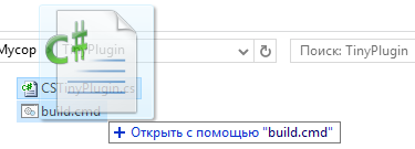

For c#:
1. Create file build.cmd
::Autor: Viacheslav N. Mezentsev (viacheslavmezentsev@ya.ru)
@echo off && cls
set dotnet=%windir%\Microsoft.NET\Framework64
if "%~x1" == ".cs" set lang=cs
if "%~x1" == ".vb" set lang=vb
for %%n in (2.0.50727,3.5,4.0.30319) do if exist "%dotnet%\v%%n\%lang%c.exe" set comp="%dotnet%\v%%n\%lang%c.exe"
if exist %comp% (
%comp% -nologo ^
-target:library ^
-lib:"%ProgramFiles(x86)%\SMath Studio" ^
-reference:System.Xml.dll,System.Data.dll,SMath.Controls.dll,SMath.Manager.dll,SMath.Math.Numeric.dll,SMath.Math.Symbolic.dll ^
-out:"%~n1.dll" %1 ) && echo SMath plugin: "%~n1.dll"

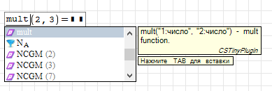

3. Build assembly using command: build CSTinyPlugin.cs
Also you can use drag and drop technique for this.
You get CSTinyPlugin.dll
5. Copy CSTinyPlugin.dll to the C:\Program Files (x86)\SMath Studio\plugins folder and restart the program.
6. Test it.

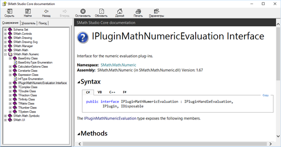

7. Read the SMath Studio Core documentation: SSCoreDoc.chm.

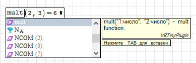

📝 Links:
1. How to create plugins for SMath Studio
2. Sample compilation command lines (Visual Basic)
3. Template project for numerical plugin (VS2017, .Net 2.0+, VB.Net)
4. SMath Studio Core documentation (CHM)
5. Developer Guide (partially obsolete)

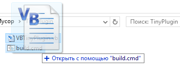

For vb.net:
2. Create source file VBTinyPlugin.vb
3. Build assembly using command: build VBTinyPlugin.vb
You get VBTinyPlugin.dll
5. Copy VBTinyPlugin.dll to the C:\Program Files (x86)\SMath Studio\plugins folder and restart the program.
6. Test it.
For vb.net:
@echo off && cls
if exist %comp% (
%comp% -nologo ^
-target:library ^
Imports System
Imports System.Reflection
Imports System.Runtime.InteropServices
Imports System.Collections.Generic
Imports SMath.Manager
Imports SMath.Math
Imports SMath.Math.Numeric
<Assembly: AssemblyTitle("VBTinyPlugin"
<Assembly: AssemblyDescription("Template project for numerical plugin."
<Assembly: AssemblyVersion("0.1.*"
' NOTE: Each plugin must have unique GUID. Use online guid generators for this.
<Assembly: Guid("FB41BCBC-11EC-4D8D-BDE1-C5772608EEA9"
Public Class Plugin
Implements IPluginMathNumericEvaluation
Private _terms As TermInfo()
Private _description As Dictionary(Of String, String) = New Dictionary(Of String, String) From {
{"ENG", "mult function."},
{"RUS", "функция умножения."}
Public Function GetTermsHandled(sessionProfile As SessionProfile) As TermInfo() Implements IPluginHandleEvaluation.GetTermsHandled
Return _terms
End Function
Public Sub Initialize() Implements IPlugin.Initialize
_terms = {New TermInfo("mult", TermType.[Function], _description("ENG"
, FunctionSections.Unknown, True,
{ New ArgumentInfo(ArgumentSections.RealNumber), New ArgumentInfo(ArgumentSections.RealNumber)}) }
End Sub
Public Function NumericEvaluation(value As Term, args As TNumber(), ByRef result As TNumber) As Boolean Implements IPluginMathNumericEvaluation.NumericEvaluation
result = args(0) * args(1)
Return True
End Function
Public Sub Dispose() Implements IDisposable.Dispose
End Sub
End Class
6. Test it.
