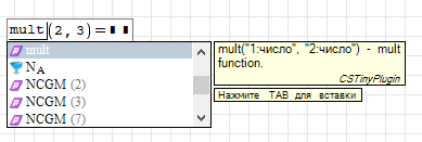

For c#:
1. Create file build.cmd
Показать спойлер
2. Create source file CSTinyPlugin.cs
Показать спойлер

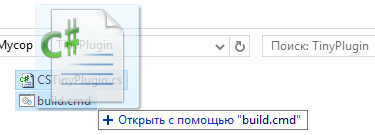

3. Build assembly using command: build CSTinyPlugin.cs
Also you can use drag and drop technique for this.
You get CSTinyPlugin.dll
5. Copy CSTinyPlugin.dll to the C:\Program Files (x86)\SMath Studio\plugins folder and restart the program.
6. Test it.

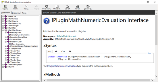

7. Read the SMath Studio Core documentation: SSCoreDoc.chm.

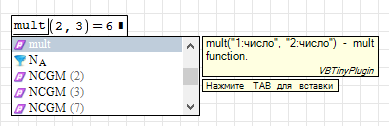

#2 Опубликовано: 06.08.2019 17:28:27
1 544 сообщений из 1 858 понравились пользователям.
📝 Links:
1. How to create plugins for SMath Studio
2. Sample compilation command lines (Visual Basic)
3. Template project for numerical plugin (VS2017, .Net 2.0+, VB.Net)
4. SMath Studio Core documentation (CHM)
5. Developer Guide (partially obsolete)
For vb.net:
Показать спойлер
2. Create source file VBTinyPlugin.vb
Показать спойлер

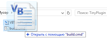

3. Build assembly using command: build VBTinyPlugin.vb
You get VBTinyPlugin.dll
5. Copy VBTinyPlugin.dll to the C:\Program Files (x86)\SMath Studio\plugins folder and restart the program.
6. Test it.
