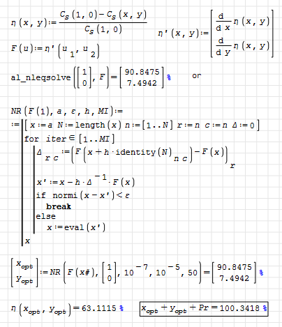

Do you know more correct method?
8-28-33-St-Isp.sm (63.66 KiB) downloaded 1342 time(s).
This one?
