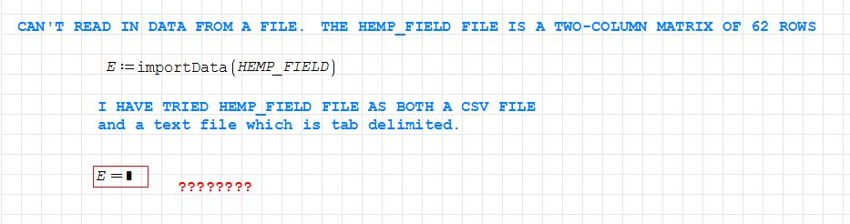

this screenshots alone can't say much about the problem; the error message, the content of HEMP_FIELD, the content of the data file are all unknown to us. Usually the best way to have fast help is to attach the involved files, better if simplified as mush as it is in your possibilities, as well as the screenshot.

Thanks Davide,
Here is an update with the actual .sm file and the actual .txt file which DOES INDEED work. I left out the quotes; however, the .csv file still does not work even with quotes in importData(1). Perhaps Smath does not like comma delimited data??????
This forum will not allow me to attach .csv files.
I would like to have the simplest import function without having to specify paths and sheet number. I notice when I copy a path from Windows 7 Professional 64 bit, it will not paste into Smath locations. That means a lot of unnecessary typing. Perhaps this could be corrected in future releases.

WrotePerhaps Smath does not like comma delimited data??????
As I've stated in the linked post, importData is a generic purpose import utility. If you use the 1-argument version, only files with period as decimal separator and tabulation/whitespace as columns separators are imported correctly. To read CSV you have to use the 9-arguments function and specify comma as column delimiter.

WroteI notice when I copy a path from Windows 7 Professional 64 bit, it will not paste into Smath locations.
I usually prefer relative locations (relative to the worksheet). About absolute paths, I can copy-paste paths in math strings without troubles (create one with double quotes in a math placeholder, then paste the path), let me know if and how you experience issues.
