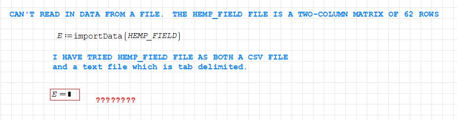

Sorry to keep asking these syntax questions, but I can't seem to import csv data into an Smath worksheet.
See attached image.

this screenshots alone can't say much about the problem; the error message, the content of HEMP_FIELD, the content of the data file are all unknown to us. Usually the best way to have fast help is to attach the involved files, better if simplified as mush as it is in your possibilities, as well as the screenshot.

Here is an update with the actual .sm file and the actual .txt file which DOES INDEED work. I left out the quotes; however, the .csv file still does not work even with quotes in importData(1). Perhaps Smath does not like comma delimited data??????

As I've stated in the linked post, importData is a generic purpose import utility. If you use the 1-argument version, only files with period as decimal separator and tabulation/whitespace as columns separators are imported correctly. To read CSV you have to use the 9-arguments function and specify comma as column delimiter.
