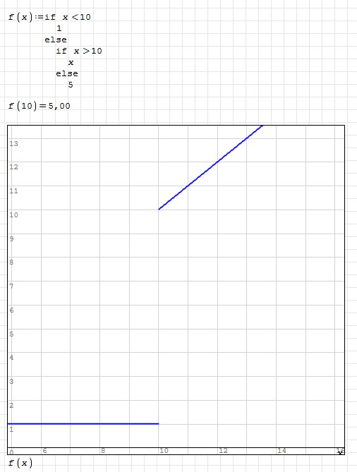

Hello!
I have a problem with simple equation. In case of my function, f(10) is equal to 5 but there is no "dot" of such value on the graph.
Please tell me how it should look like.
Where is the dot.sm (3.2 KiB) downloaded 1189 time(s).

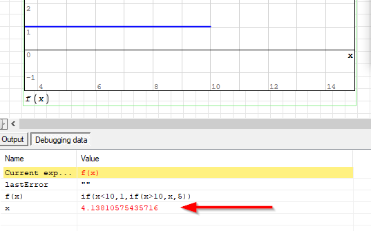

1,443 likes in 2,935 posts.
think the issue is the auto-generated range does not include the point x=10 exactly and therefore never reaches the point where f(x) = 5
That's part of "the point". The function has to be drawn on the canvas, thus it is calculated for each pixel, and each pixel correspond to a value that depends on the range (first and last values visible), and even on the number of pixels (the width of the canvas).
You can figure it easily placing a breakpoint in the plot placeholder and looking at the values of x.
You must be very lucky to hit exactly 10.000000000000000 (15 digits)

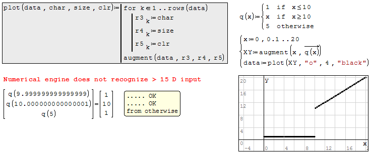

#8 Posted: 2018/11/20 16:14:02
Your setup is not correct. Once in a while, undefined condition(s) do not reflect.
In very rare instances, it's the other way around, i.e: one of the condition must
be undefined wrt the algorithmic suite [typical => De Boor spline point].
Where is the dot discrete.sm (6.82 KiB) downloaded 1166 time(s).

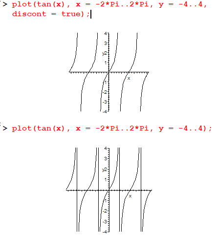

Maple have following functions, but need readlib for the following two:
Also can use this option for plots:
I see your point. I found a piecewise plotting example with removable discontinuity in maple here (need to scroll down).
A couple points to note. Generally, I don't think something like fdiscont would work for piecewise functions with single point discontinuities or perhaps even jump continuities. It mentions issues with these in the description.
I notice that both Maple and Matlab have "piecewise" functions. I assume that in those environments the "piecewise" functions may be an indicator to the "plot" function that specific conditions exist for which the function needs to be evaluated. Therefore the plot function will evaluate the boundary conditions.
Perhaps in SMath something similar could be implemented s.t. when a function is passed into the plot and it is specified as a piecewise function, it will evaluate any conditions specified within the range that aren't part of the auto-generated range.
I'm not certain if it's necessary to indicate that a function is intended to be piecewise continous within SMath or if SMath is smart enough to determine intent by the structure of the function itself. I do not think, generally, any function with conditionals can be considered piecewise, but I'm not sure if that's true.

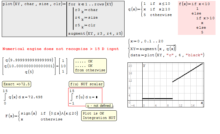

#14 Posted: 2018/11/21 13:04:22
Mon ami, your point is SO fundamental
Those things appeared ad-nauseum in Mathsoft Collaboratory.
Mathcad up to 11, was a bit more understanding, but wrong by principle
because confusing because not telling the truth. A piece-wise function
MUST be specified completely. On that, Smath is absolutely correct.
There are other things under the hood related to this discussion:
Integration of erf(x), and Gamma(x), the integrand must be vectorized.
Indirectly, it kind of depends upon of discontinuous approximation
of these two functions, the only two I have detected.
Most/most important about discontinuous is the major difference between
if/else and if/otherwise. Generally, they do the same but they aren't.
EXPLAIN: if/else is not scalar and it will not integrate a completely
specified if/else function. On the other hand, if/otherwise is scalar
thus will integrate. They both plot the same to add to the confusion.
Demonstrated => Integrate Discontinuous [Nuance].
Demonstrated => Where is the Dot Discrete.
It may even be more important if the path of integration is discontinuous.
Where is the dot discrete.sm (19.27 KiB) downloaded 1186 time(s).
Integrate Discontinuous [Nuance].sm (24.75 KiB) downloaded 1044 time(s).

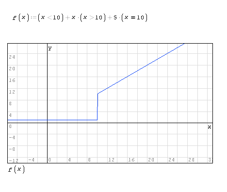

#15 Posted: 2018/11/22 12:56:46
Oscar Campo
Oscar Campo
135 likes in 309 posts.
Hello!
I have a problem with simple equation. In case of my function, f(10) is equal to 5 but there is no "dot" of such value on the graph....
In a more compact form you can view no discontinuities

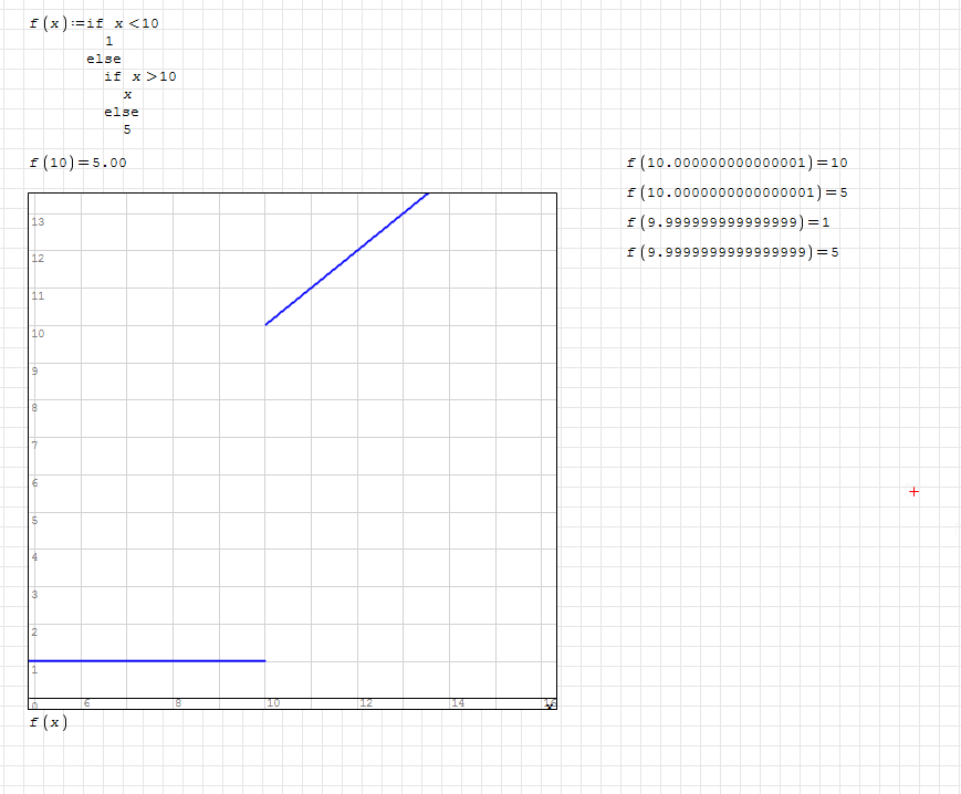

#17 Posted: 2018/11/22 15:54:18
...It would be interesting to know why it works this way , just for sake of understanding; looks to me that the merging of several OR operations should be linked to this different (... and positive )behaviour.
Franco
They behave the same way; in the first post the plot was made with "Graph by points" enabled.
