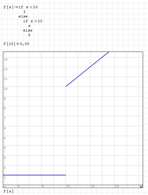

Hello!
I have a problem with simple equation. In case of my function, f(10) is equal to 5 but there is no "dot" of such value on the graph.
Please tell me how it should look like.
Where is the dot.sm (3,2 КиБ) скачан 1337 раз(а).

Fridel Selitsky
Fridel Selitsky
Just point x=10 must be drawn
#3 Опубликовано: 20.11.2018 13:23:46
Michał Janowski
Michał Janowski
1 сообщений из 7 понравились пользователям.
I think, that it is not proper solution. That "point" is already included in definition of the function, so why I should draw it manually. What in case, if the function is more complex and I don't know that there is such orphaned value in the middle of continous parts of function just from looking on the function definition. Your solution is correct in situation if we exactly know that there is such thing. It should be drawn on the graph somehow automatically, but it's not.
Best regards,
Mroczak

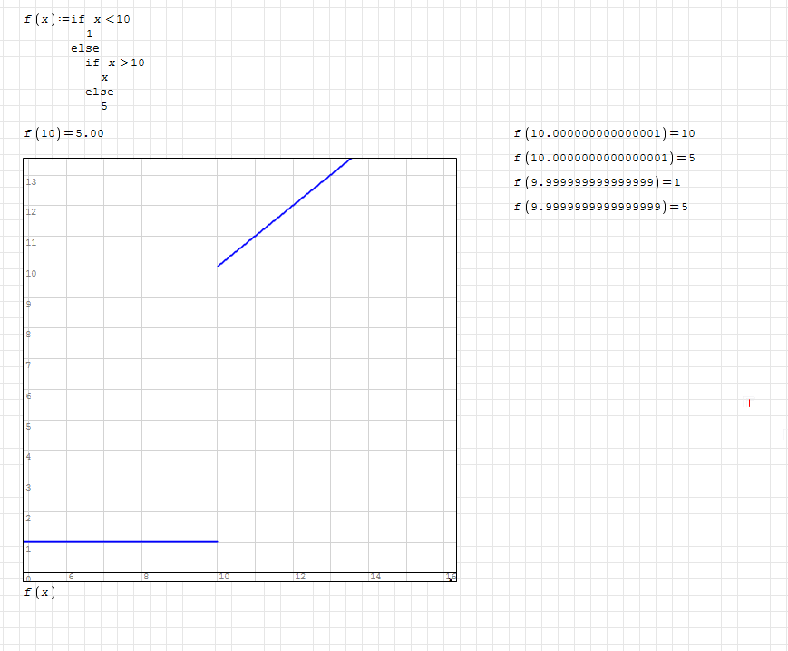

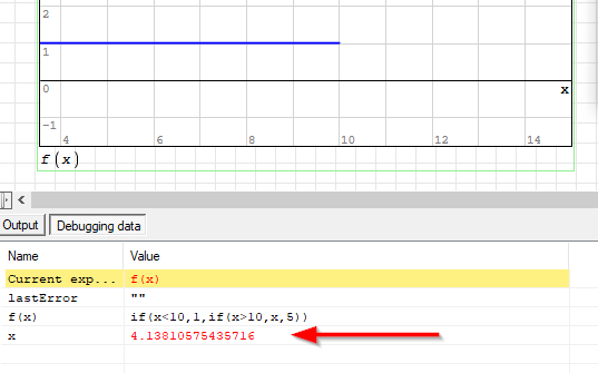

#6 Опубликовано: 20.11.2018 15:09:48
think the issue is the auto-generated range does not include the point x=10 exactly and therefore never reaches the point where f(x) = 5
That's part of "the point". The function has to be drawn on the canvas, thus it is calculated for each pixel, and each pixel correspond to a value that depends on the range (first and last values visible), and even on the number of pixels (the width of the canvas).
You can figure it easily placing a breakpoint in the plot placeholder and looking at the values of x.
You must be very lucky to hit exactly 10.000000000000000 (15 digits)

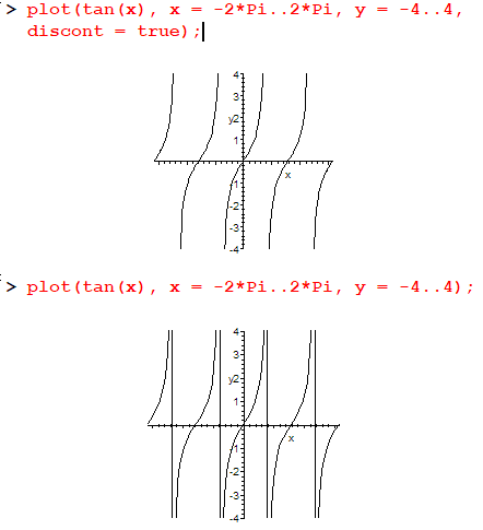

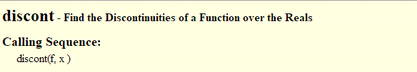

#10 Опубликовано: 20.11.2018 19:56:45
1 138 сообщений из 1 805 понравились пользователям.
the issue -in my modest opinion - is only on the plot side
Yes and no. You cannot really expect the program to know to evaluate/plot at a specific point for any arbitrary function.
Hi. Yes, you can. With the normal issues for symbolic or numeric manipulations. And as frapuano talk, in some moment we need to implement some code for handle singularities. As an example, maybe too much specific, but about finite jumps, you can see
https://en.smath.info/forum/yaf_postst14910_Round.aspx and the implementation of discontinuous plots in round.sm (69,17 КиБ) скачан 1575 раз(а).
Maple have following functions, but need readlib for the following two:
Also can use this option for plots:

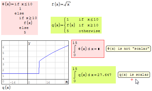

#14 Опубликовано: 21.11.2018 13:04:22
I'm not certain if it's necessary to indicate that a function is intended to be piecewise continous within SMath or if SMath is smart enough to determine intent by the structure of the function itself. I do not think, generally, any function with conditionals can be considered piecewise, but I'm not sure if that's true.
Mon ami, your point is SO fundamental
Those things appeared ad-nauseum in Mathsoft Collaboratory.
Mathcad up to 11, was a bit more understanding, but wrong by principle
because confusing because not telling the truth. A piece-wise function
MUST be specified completely. On that, Smath is absolutely correct.
There are other things under the hood related to this discussion:
Integration of erf(x), and Gamma(x), the integrand must be vectorized.
Indirectly, it kind of depends upon of discontinuous approximation
of these two functions, the only two I have detected.
Most/most important about discontinuous is the major difference between
if/else and if/otherwise. Generally, they do the same but they aren't.
EXPLAIN: if/else is not scalar and it will not integrate a completely
specified if/else function. On the other hand, if/otherwise is scalar
thus will integrate. They both plot the same to add to the confusion.
Demonstrated => Integrate Discontinuous [Nuance].
Demonstrated => Where is the Dot Discrete.
It may even be more important if the path of integration is discontinuous.
Where is the dot discrete.sm (19,27 КиБ) скачан 1352 раз(а).
Integrate Discontinuous [Nuance].sm (24,75 КиБ) скачан 1177 раз(а).

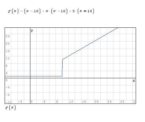

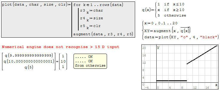

#15 Опубликовано: 22.11.2018 12:56:46
Oscar Campo
Oscar Campo
Hello!
I have a problem with simple equation. In case of my function, f(10) is equal to 5 but there is no "dot" of such value on the graph....
In a more compact form you can view no discontinuities
frapuano 22.11.2018 15:28:00
#16 Опубликовано: 22.11.2018 15:34:31
frapuano
frapuano
13 сообщений из 115 понравились пользователям.
...It would be interesting to know why it works this way , just for sake of understanding; looks to me that the merging of several OR operations should be linked to this different (... and positive )behaviour.

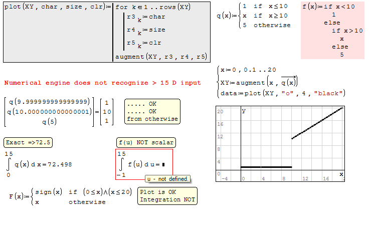

#18 Опубликовано: 22.11.2018 17:29:35

#19 Опубликовано: 23.11.2018 01:32:02
The same plot in Mathcad will shows no apparent break @ 5.
Mathcad plots on ½ pica thus plots straight lines, thus not fine/pleasant look.
Smath plots on pixel thus the discontinuous were there is no ½ pixel.
A scalar function is a function that runs on a vanishing iterator 'x' .
Smath does not calculate ln(,), exp(,) ... it fetches from Windows.
Most if not all functions are approximations of 21 decimals.
i.e: Normalized Padé Rational Fractions.
Result may be only 18 Decimals. Thus, by convention results are
truncated to 15 decimals. Symbolic Engines is another story.
High accuracy Main-Frames may run Chebyshev of very high numerical
stability 25 decimals [typical Clenshaw ...]
Normalized Rational Fraction approximates on various best range wrt
to minimal arithmetic operations. Each function has its own specific range
generally very small. More numerical maths kind of scale the base range
to accommodate the 'x' of greater value than the base approximation,
naturally up to the max of the result < 10^307.
Before the event of rational approximations the first IBM used
continued fraction for the principal ln(x), exp(x), sqrt(x) ...
Can't help more about unknown math suite/use of the proposal.
