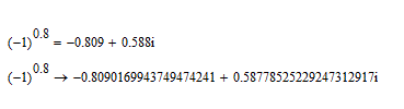

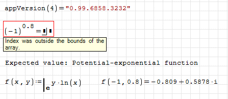

Hi. Just some mistake.
Potential-exponential function error.sm (4.07 KiB) downloaded 758 time(s).

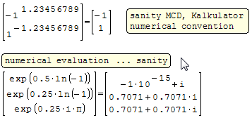

The default convention is a bug by itself.
That it does not default to "convention" suggests incomplete user coding.
Maths Exp(,) Convention.sm (26.12 KiB) downloaded 710 time(s).

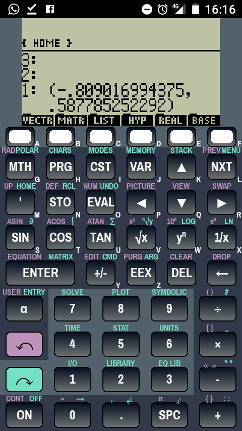

Calculators given the same answer. Here Droid 48 for Android

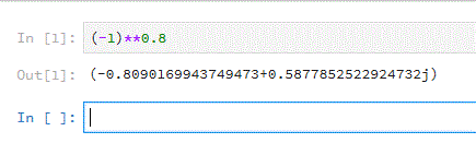

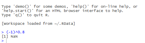

#5 Posted: 2018/10/16 03:08:54
Mathcad
Python
R
