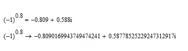

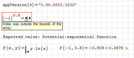

Hi. Just some mistake.
Potential-exponential function error.sm (4.07 KiB) downloaded 1409 time(s).
#2 Posted: 10/15/2018 3:49:48 PM
The default convention is a bug by itself.
That it does not default to "convention" suggests incomplete user coding.
Maths Exp(,) Convention.sm (26.12 KiB) downloaded 1378 time(s).

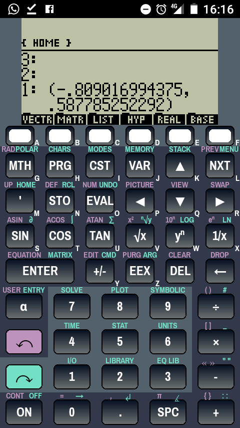

Calculators given the same answer. Here Droid 48 for Android

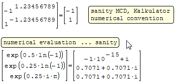

#4 Posted: 10/15/2018 9:03:34 PM
Just some mistake.
Strictly a bug. Visit l'Hospital rules and the likes.
i.e: this undetermined is determined.

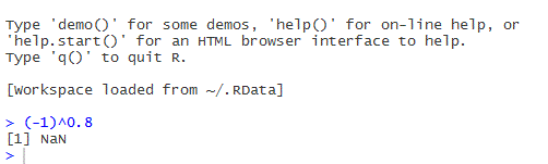

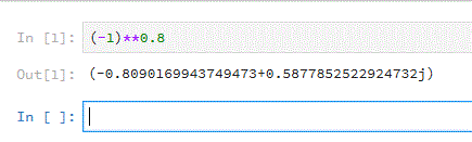

Mathcad
Python
R
