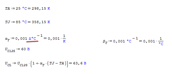

How to compute this
#6 Posted: 2020/11/10 12:20:49
127 likes in 342 posts.
The problem is due to the internal storage of the program in Kelvin. You find several threads in the forum. you can also find an explanation in Martin Kraska's interactive guide (Tools menu -> Options -> Plugins -> interactive books). However the solution is to use DeltaC °
Davide Carpi 2020/11/12 10:10:00
Thanks a lot.

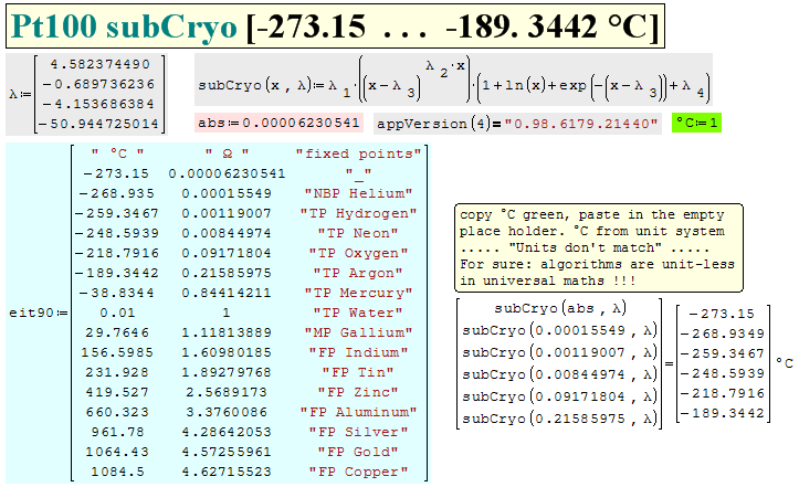

#11 Posted: 2020/11/14 14:24:48
wrong display of output units
You will have infinitely many of those, easy to doctor:
1. make the system silent, though not quite paper/pencil
2. make it user style at will.
