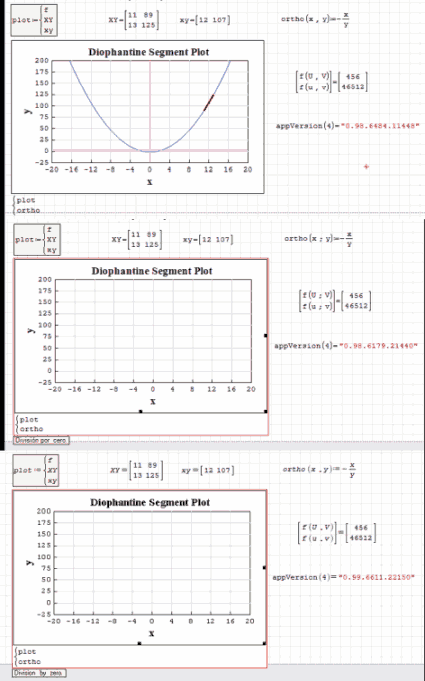

It happens, correct during the session of construction,
but fails on re-opening PC [little pest].
Solve Diophantine X_Y Plot.sm (25.08 KiB) downloaded 1149 time(s).

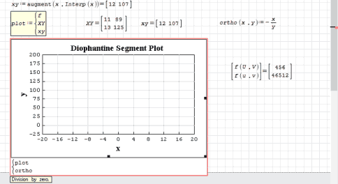

Your file gives me the error of division by zero in the graph.
Hello Carlos,
In the collected plot, neither f, XY, xy can issue this error message.
Hope not, otherwise X_Y would be all bug.

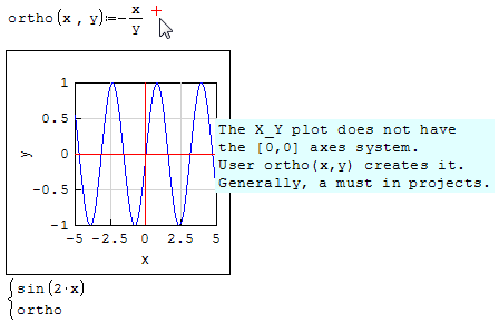

The module ortho(x,y):= -x/y may be the guilty. Try to remove it.

your file runs perfectly in the version of Smath Studio "0.98.6484.11448",
and fails in the versions "0.98.6179.21440" and "0.99.6611.22150", the error

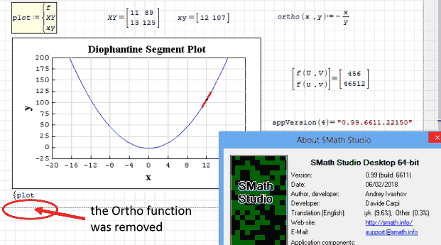

is caused by the function "Ortho = -x / y". If this function is removed from
the graph, the error is eliminated, but only Parabola is plotted.
Carlos

I have it the other way around: 6179 working great on XP Pro
6484 scrapped two work sheets, because I tried only two !!!
Whatever: there is a concurrent bug wrt X_Y wrt Smath versions.
Doctor one version, scrap the other one ... pest !
Cheers Carlos, Jean.

I have checked your worksheet and see question we have here is not about stable/not stable, this is about environment. I have checked different versions of SMath Studio (including 0.98.6484.11448, 0.98.6179.21440, 0.99.6611.22150) - error is shown everywhere.
Then I've tried to open SMath Studio in 32-bit mode and this helped! When it is 32-bit worksheet calculated without errors and graph is shown correctly.
So this is about 32/64 bit and present in all versions of the program.
(build 6615 32 bit = build 6611 64 bit)

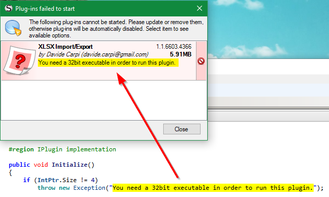

WroteThe bitness is also known to be relevant for the function of 32bit mathcad user libraries in the Mathcad EFI plugin. These require SMath Studio running in 32 bit mode. I am not aware of plugins which insist on 64 bit mode, therefore my portable pre-configured distribution is generally set to 32 bit. It is in fact very easy to do using the CorFlags executable posted by uni somewhere in the forum.

The bitness issue is typical of p/invoked libraries or external processes, something that smath can't manage automatically (except maybe introducing in the interface a flag that the plugin author can set manually to explicitly declare the plugin incompatible); however the developer can already throw an exception during the initialization to prompt the incompatibility to the user (mathcad efi f.e. has this check but it is suppressed in favor of his internal logger)
WroteHere the question is:
How is it possible that by removing the Ortho function
from the graph, the file will work correctly?
What does the definition of the function
Ortho (x, y) = - x / y have to do with the version at 32 to 64 bit?
