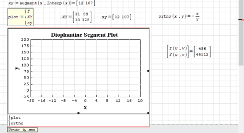

Maybe your work sheet needs be doctored as well as mine.
It happens, correct during the session of construction,
but fails on re-opening PC [little pest].
Solve Diophantine X_Y Plot.sm (25,08 КиБ) скачан 1320 раз(а).

Hello Jean

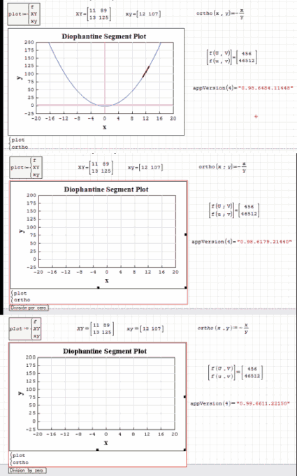

Your file gives me the error of division by zero in the graph.
Carlos

#4 Опубликовано: 09.02.2018 23:20:28
Hello Jean
Hello Carlos,
In the collected plot, neither f, XY, xy can issue this error message.
Hope not, otherwise X_Y would be all bug.

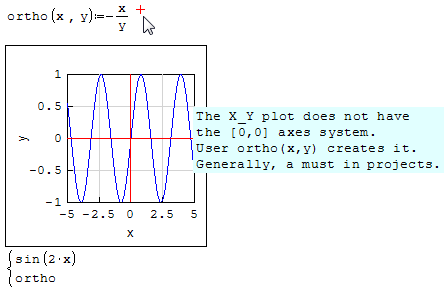

The module ortho(x,y):= -x/y may be the guilty. Try to remove it.

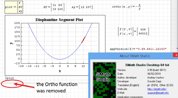

Hello Jean,
your file runs perfectly in the version of Smath Studio "0.98.6484.11448",
and fails in the versions "0.98.6179.21440" and "0.99.6611.22150", the error
is caused by the function "Ortho = -x / y". If this function is removed from
the graph, the error is eliminated, but only Parabola is plotted.

Jean,
In fact, no Smath stable version is stable.
The latest, declared stable, will be after evaporating any traces of previous
installed version.
I would disagree with you. Beta versions usually much more unstable. But yes, sometimes I make mistake and build 6606 should not be marked as Stable, because I've missed something very important. But this is exception. F.e. latest stable is really good.

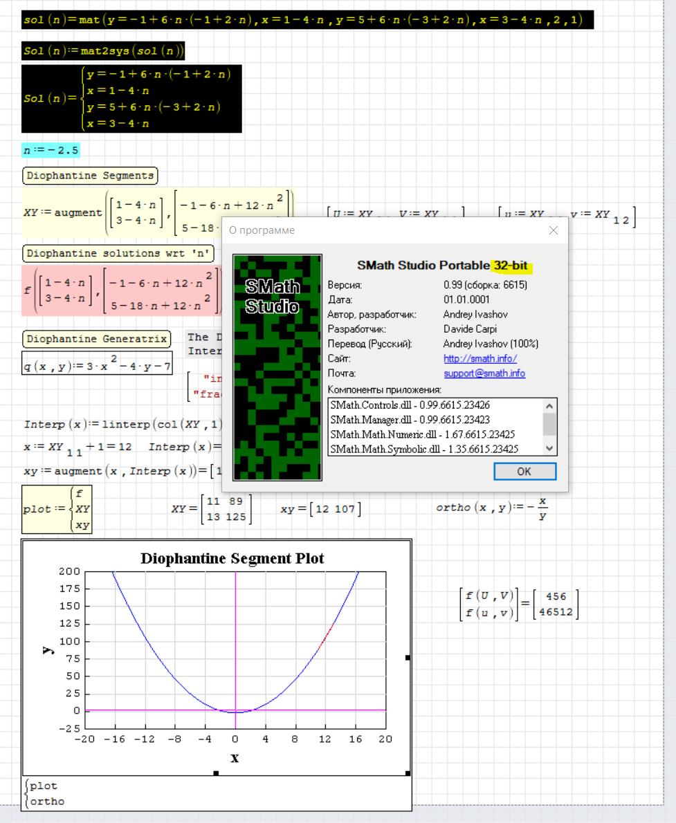

I have checked your worksheet and see question we have here is not about stable/not stable, this is about environment. I have checked different versions of SMath Studio (including 0.98.6484.11448, 0.98.6179.21440, 0.99.6611.22150) - error is shown everywhere.
Then I've tried to open SMath Studio in 32-bit mode and this helped! When it is 32-bit worksheet calculated without errors and graph is shown correctly.
So this is about 32/64 bit and present in all versions of the program.
(build 6615 32 bit = build 6611 64 bit)

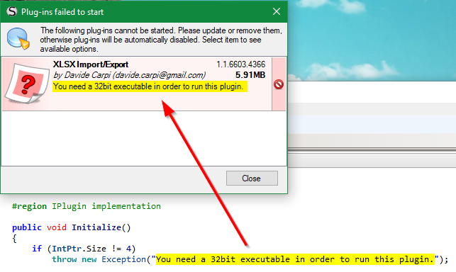

The bitness issue is typical of p/invoked libraries or external processes, something that smath can't manage automatically (except maybe introducing in the interface a flag that the plugin author can set manually to explicitly declare the plugin incompatible); however the developer can already throw an exception during the initialization to prompt the incompatibility to the user (mathcad efi f.e. has this check but it is suppressed in favor of his internal logger)

Here the question is:
How is it possible that by removing the Ortho function
from the graph, the file will work correctly?
What does the definition of the function
Ortho (x, y) = - x / y have to do with the version at 32 to 64 bit?

Possibly, the plugin uses different libraries for different functions. Depending on what function is actually used, this may lead to a conflict or not.
Ortho uses the implicit plot feature which might depend on a 32 bit lib.
This is just a guess but it could be that way. No need to dig deeper if setting SMath to 32 bit is on the safe side for ordinary usage. Otherwise you just can examine the visual studio project for dependencies.

Good question. I see that you can get rid of the issue if you change the limits of the y axis. I think that the issue might be in some double value rounded differently in 64bit vs 32 bit... also the plugin is not based on external libraries... must be debugged
