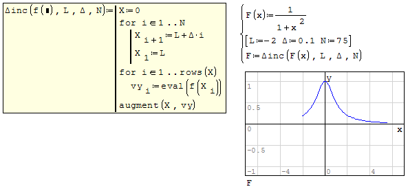

Hi Norm. Some few notes:
- For speed up the code, you must to put at some places some eval() in SMath.
- Some vectorization are automatics in Mathcad, but not in SMath. Here you can use the index nk instead implicit or explicit vectorization, as shows the picture.
- N0.gc is 2^8, and it is for use as the finite index for fast Fourier sums, but it's too big for SMath. Use something lower.
- T.hw is undefined in you worksheet.
