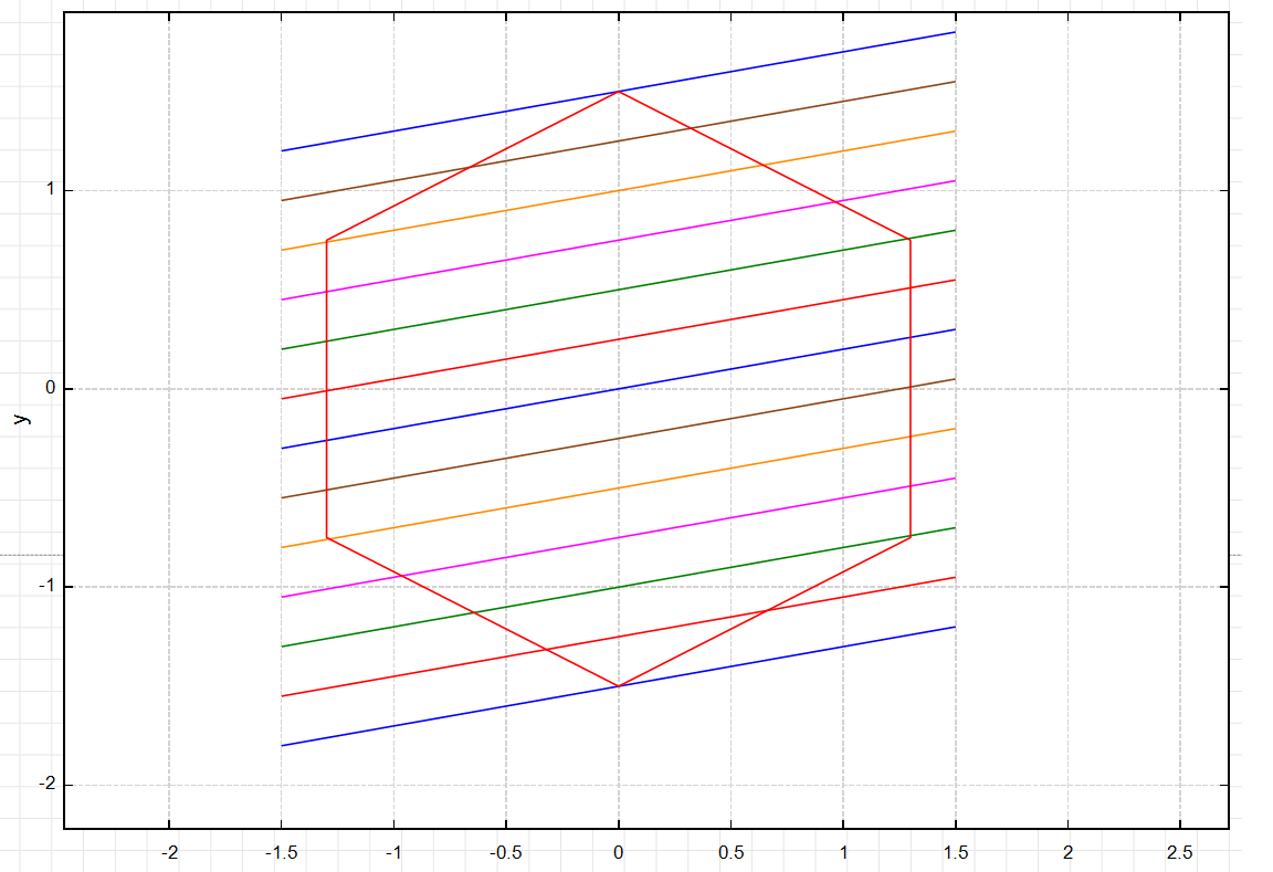

Hi everyone ,I'm doing a momentum curvature usign Popovic's Method and found a big problem beacuse to divide a polygon(convex and concave) into small fiber like this image but with more lines:
General Polygon
it's not so easy to do an algorithm. I did a smath file when the polygon it's rectangular but for more general case my smath code doesn't work, I'd like know an algorithm, code or function if it's posible in smath or other language to develop.

Hi Jean, it was a good solution and you give some ideas to do a code but I'd like to do for more lines and I'd like to optimize the code or algorithm. I did a code in smath maybe need to optimize some parts and get some interesting results, i hope you take a look because a I'd like to aply to convex and no convex polygon, I think it's so hard but I'd like to know the algorithm or code that other programs use. My code doesn't work for some slopes though

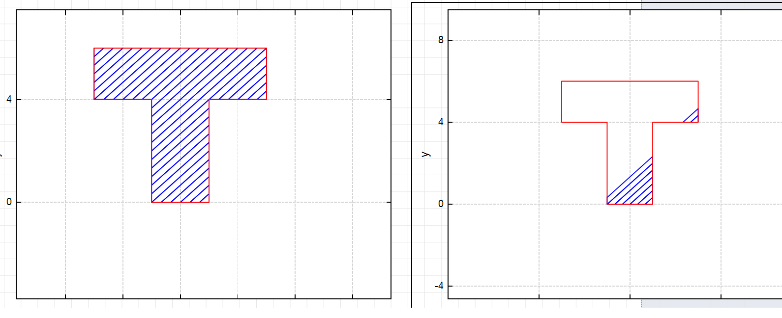

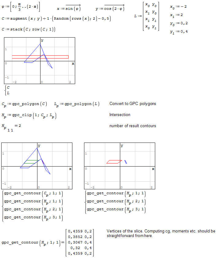

This might be an application for the GPC wrapper plugin by Davide.
gpc1.sm (12.5 KiB) downloaded 1197 time(s).

Hi Jean it's an excellent solution, thank you so much , I did a code with GPC plugin and I could get this results.
polygon_irregular_fiber_borrador1.sm (34.31 KiB) downloaded 1219 time(s).
polygon_regular_fiber_borrador1.sm (35.48 KiB) downloaded 1205 time(s).

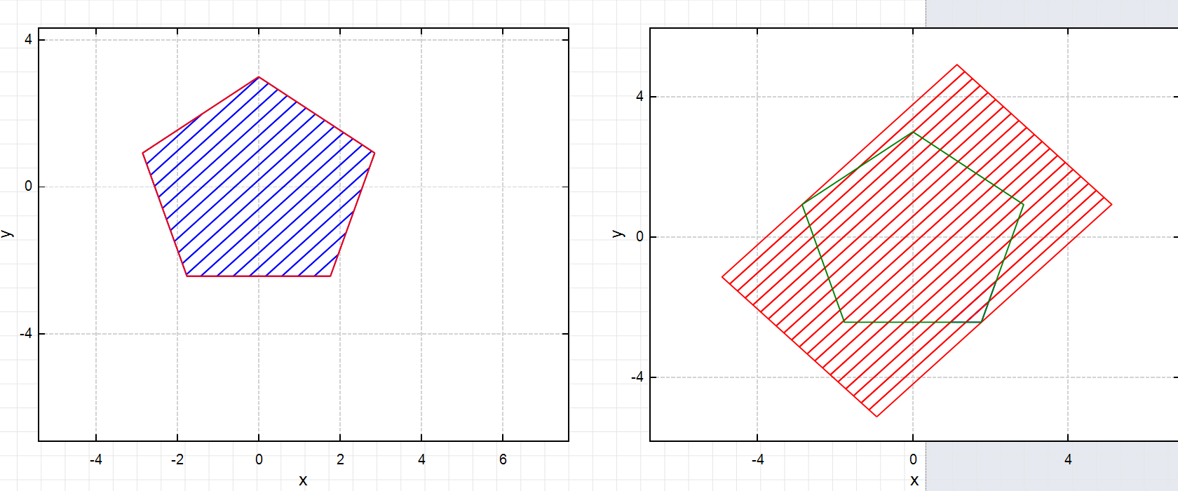

General hatching procedure for arbitrary contours
gpc2.sm (42.6 KiB) downloaded 1226 time(s).

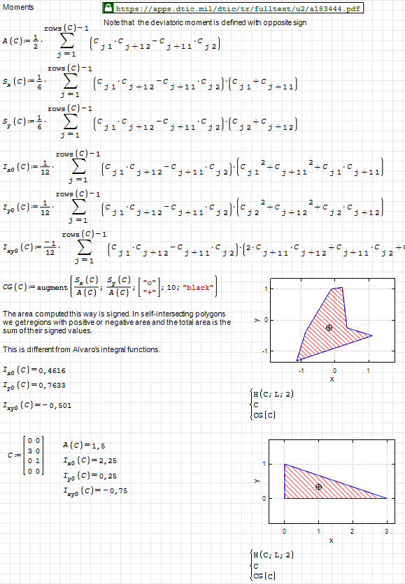

Will we be able to calculate the static moment and the moment of inertia of any section with these tools?
#14 Posted: 2022/8/2 06:41:33
1,355 likes in 2,271 posts.
gpc3.sm (135.5 KiB) downloaded 1281 time(s).
sergio 2022/8/2 11:10:00

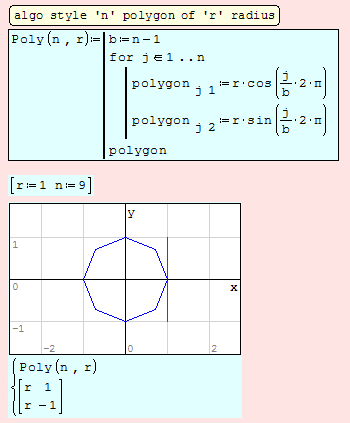

#16 Posted: 2022/8/2 11:16:59
... refreshed for convenience.
Maths Polygon Create.sm (99.71 KiB) downloaded 1205 time(s).
