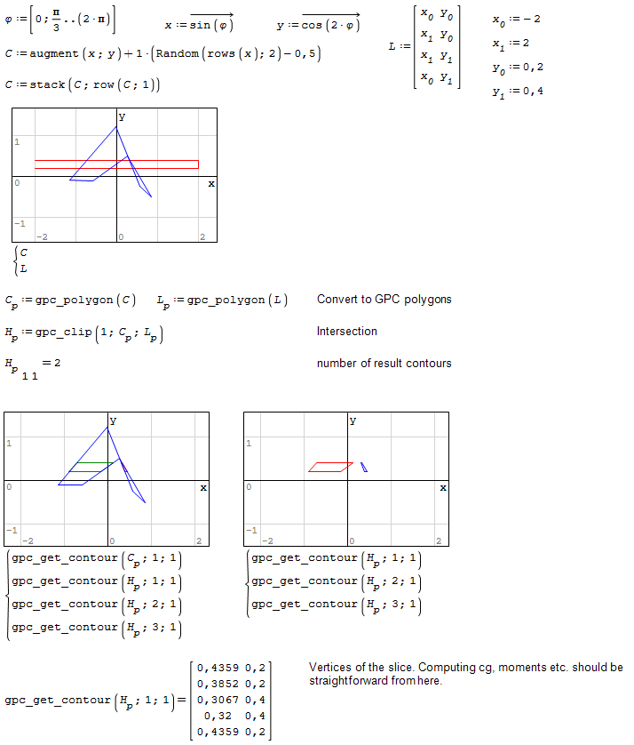

This might be an application for the GPC wrapper plugin by Davide.
gpc1.sm (12,5 КиБ) скачан 1373 раз(а).

Hi Jean it's an excellent solution, thank you so much , I did a code with GPC plugin and I could get this results.
polygon_irregular_fiber_borrador1.sm (34,31 КиБ) скачан 1407 раз(а).
polygon_regular_fiber_borrador1.sm (35,48 КиБ) скачан 1388 раз(а).

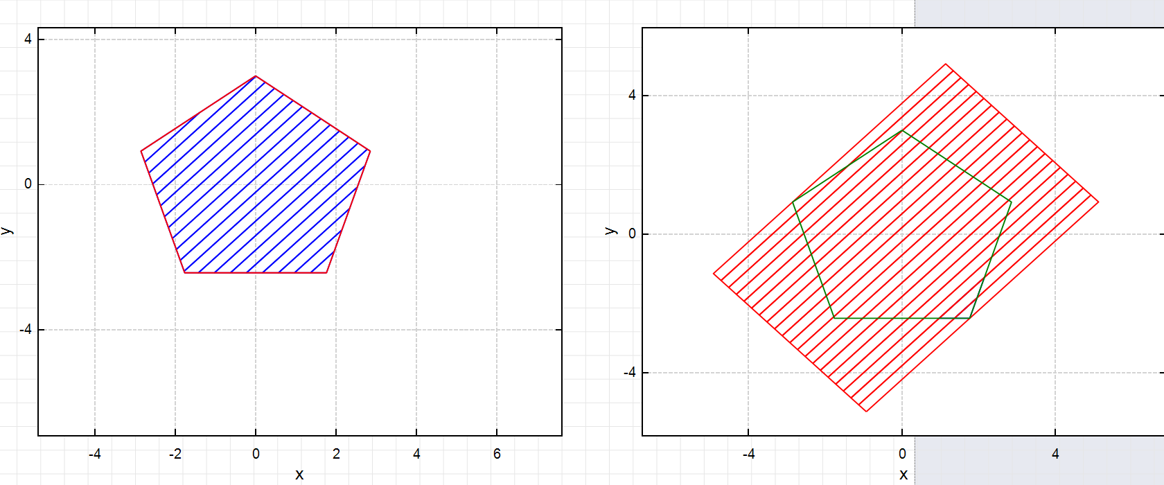

#11 Опубликовано: 01.08.2022 19:06:15

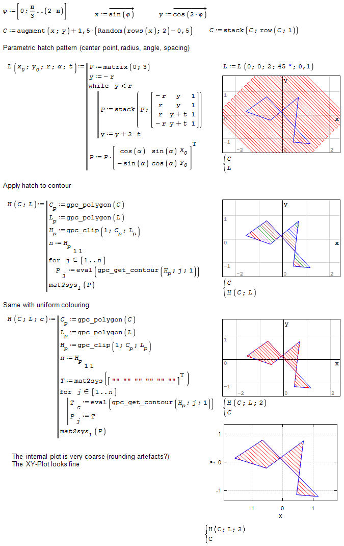

General hatching procedure for arbitrary contours
gpc2.sm (42,6 КиБ) скачан 1422 раз(а).

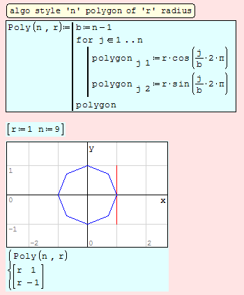

Hi. In the attached, a function for see if a point is inside or outside a polygon, and a code for double integrals using Gauss-Legendre coefficients.
InPoly.pdf (97,1 КиБ) скачан 827 раз(а).
InPoly.sm (43,3 КиБ) скачан 1357 раз(а).

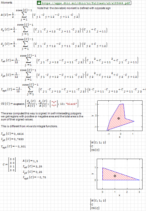

Will we be able to calculate the static moment and the moment of inertia of any section with these tools?

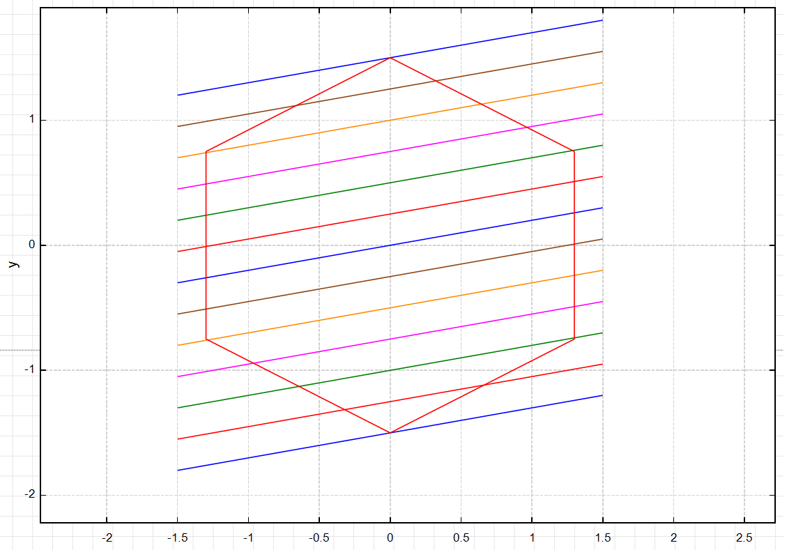

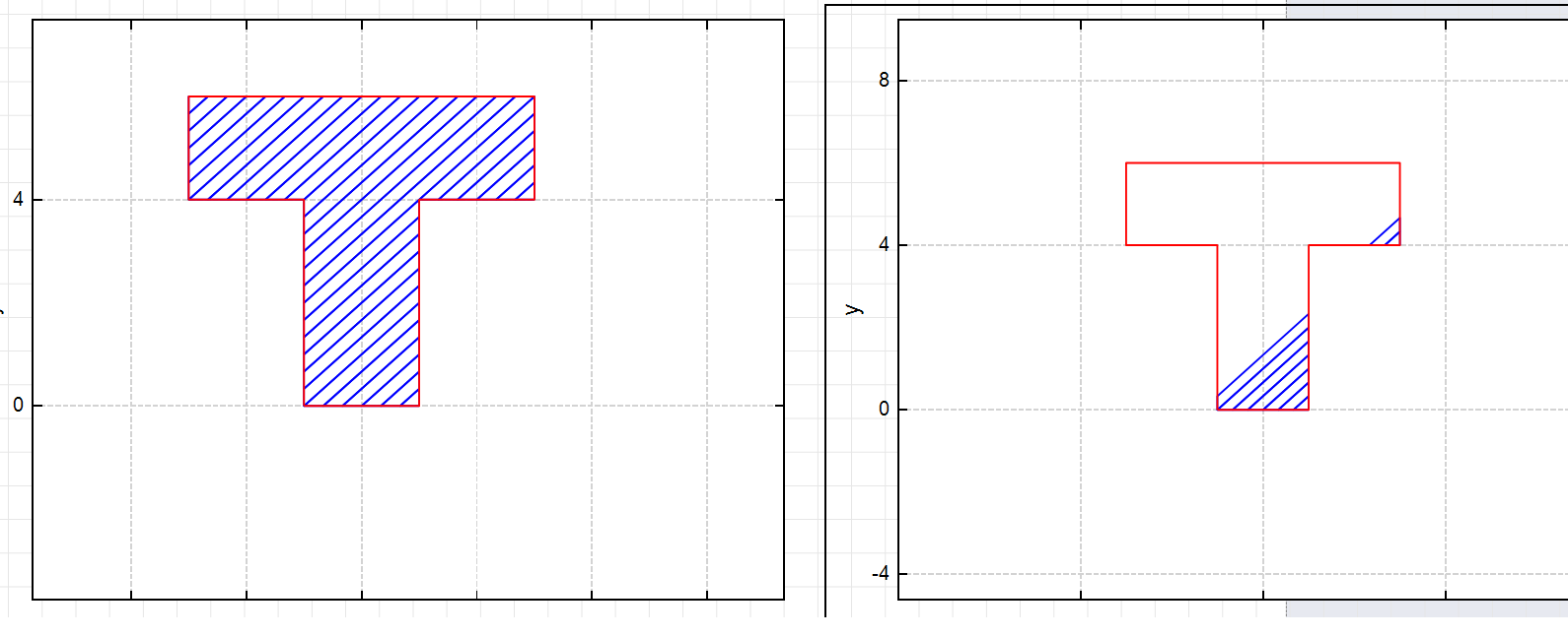

#14 Опубликовано: 02.08.2022 06:41:33
gpc3.sm (135,5 КиБ) скачан 1478 раз(а).
sergio 02.08.2022 11:10:00

... refreshed for convenience.
Maths Polygon Create.sm (99,71 КиБ) скачан 1392 раз(а).

I guess we can not use the same matrix of contour point to get the area and de center of mass ... Or am I wrong ?
