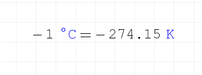

In Smath Solver, I guess -1℃ is treated as -1 × 1℃ → -1 × (273.15K + 1K) → -274.15K, not (273.15K - 1K) → 272.15K.
Is there any way to put in the negative sign, not minus?

I found the caution with negative numerical values in the Introduction Manual.
-1℃ to be put as (-1)℃ for correct calculation.

As already told in #2 in this topic, you can use paranthesis.
