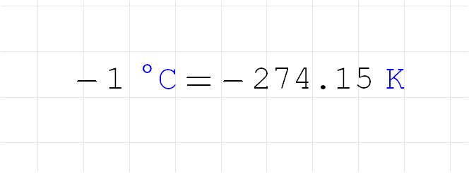

In Smath Solver, I guess -1℃ is treated as -1 × 1℃ → -1 × (273.15K + 1K) → -274.15K, not (273.15K - 1K) → 272.15K.
Is there any way to put in the negative sign, not minus?

I found the caution with negative numerical values in the Introduction Manual.
-1℃ to be put as (-1)℃ for correct calculation.

Thanks for the link! After reading section 3.6, I see why the software behaves this way. However, for quick calculations, is there a standard 'workaround' you recommend to treat 1°C as 272.15K without manually adding/subtracting 273.15 every time?
#5 Опубликовано: 16.03.2026 12:31:27
599 сообщений из 1 380 понравились пользователям.
As already told in #2 in this topic, you can use paranthesis.
