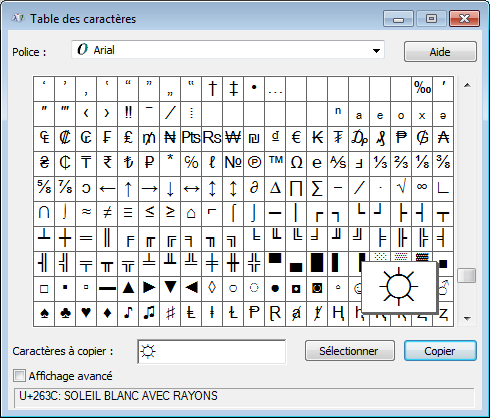

Hi IAks,
You don't need a plugin, just the right Unicode character (you can copy and paste the character from one site like Wikipedia, tamasoft.co.jp, alanwood.net or you can add the character holding the U and typing a #CODE# from the numpad)
look the attachments
regards,
w3b5urf3r
solar.sm (1.73 KiB) downloaded 723 time(s).

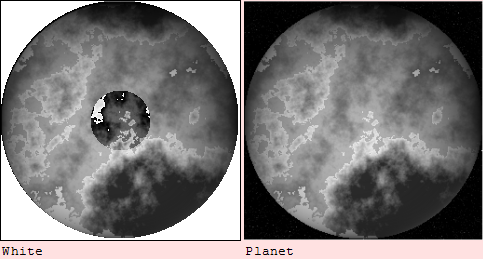

WroteIn astronomy I need to use a symbol that looks like a circle with a dot in the middle as a subscript
... from 6 years old .
Tentatively we can highlight a specific circular region.
The attached were left unfinished.
Image Planet Luminosity_1.sm (100.57 KiB) downloaded 624 time(s).
Image Planet c(planet)planet.sm (79.22 KiB) downloaded 651 time(s).
Image Planet fmap.sm (183.45 KiB) downloaded 680 time(s).
Image Planet Luminosity.sm (219.14 KiB) downloaded 605 time(s).
Image Planet Luminosity_2.sm (236.04 KiB) downloaded 610 time(s).
Image Planet Gamma.sm (315.73 KiB) downloaded 676 time(s).
