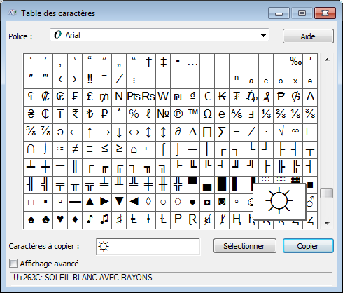

Hi IAks,
You don't need a plugin, just the right Unicode character (you can copy and paste the character from one site like Wikipedia, tamasoft.co.jp, alanwood.net or you can add the character holding the U and typing a #CODE# from the numpad)
look the attachments
regards,
w3b5urf3r

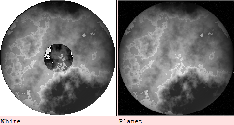

... from 6 years old .

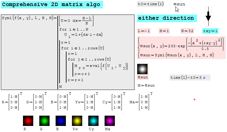

Tentatively we can highlight a specific circular region.
The attached were left unfinished.
Image Planet Luminosity_1.sm (100,57 КиБ) скачан 1253 раз(а).
Image Planet c(planet)planet.sm (79,22 КиБ) скачан 1248 раз(а).
Image Planet fmap.sm (183,45 КиБ) скачан 1274 раз(а).
Image Planet Luminosity.sm (219,14 КиБ) скачан 1210 раз(а).
Image Planet Luminosity_2.sm (236,04 КиБ) скачан 1237 раз(а).
Image Planet Gamma.sm (315,73 КиБ) скачан 1286 раз(а).
