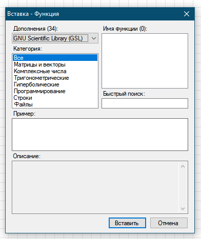

Плагин установлен и виден в SMath, но ни одна его функция не доступна. В чем может быть дело?
The plugin is installed and visible in SMath, but none of its functions are available. What can be wrong?
Windows 10 Home x64 21H1, SMathStudioDesktop portable (mono).
Upd: Разобрался. Нужен Microsoft Visual C++ 2015 Redistributable.
Understood. Requires Microsoft Visual C++ 2015 Redistributable.
https://www.microsoft.com/ru-ru/download/details.aspx?id=53840

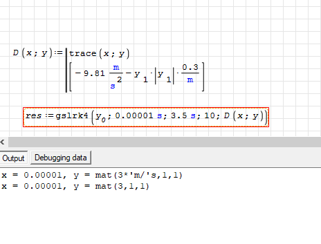

Would it be possible to correctly handle units in formulas. Right now, units are present in the first step but then stripped away breaking formulas.
#35 Posted: 2024/10/8 22:51:35
1,554 likes in 1,864 posts.
I'll think about it. There are about 30 types of solvers supported now and I'll need to rework them all. If I can rework a few solvers, I'll use that experience to update the rest. But I can't promise anything yet.
