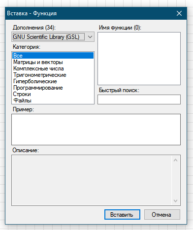

Плагин установлен и виден в SMath, но ни одна его функция не доступна. В чем может быть дело?
The plugin is installed and visible in SMath, but none of its functions are available. What can be wrong?
Windows 10 Home x64 21H1, SMathStudioDesktop portable (mono).
Upd: Разобрался. Нужен Microsoft Visual C++ 2015 Redistributable.
Understood. Requires Microsoft Visual C++ 2015 Redistributable.
https://www.microsoft.com/ru-ru/download/details.aspx?id=53840

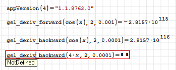

Hi Viacheslav. Thanks. I forgot to tell the operating system: Win10 32 bit. I check the 64 bit version and works fine, as you says. The library gsl32.dll seems to need vcruntime140.dll and msvcp140.dll. I see if I can update Microsoft Runtime support library also.
WroteI forgot to tell the operating system: Win10 32 bit.
There really is a problem with the 32-bit version of the GSL. I can't debug the function because it gives me an error. This may be due to the project settings for building the 32-bit version of the plugin.
P.S. Only some of the functions in the 32-bit version of the library do not work.
Alvaro 05.03.2024 12:49:00
I'll think about it. There are about 30 types of solvers supported now and I'll need to rework them all. If I can rework a few solvers, I'll use that experience to update the rest. But I can't promise anything yet.
