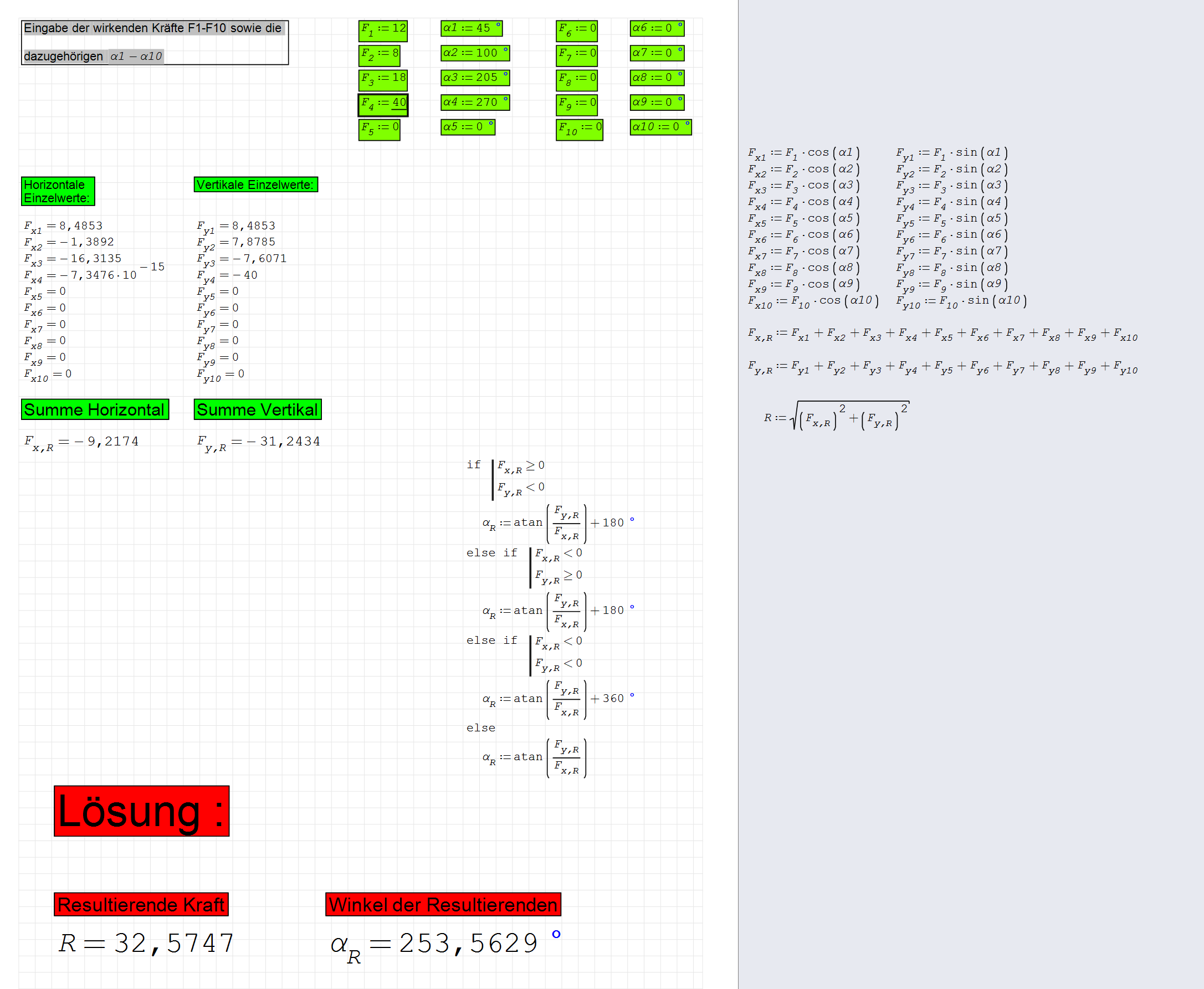

Hey, ich versuche eine If schleife zu schreiben, die von 2 Werten abhängt und je nachdem ob die Kombination "positiv Positiv" , "Positiv negativ" oder "Negativ negativ" ist soll ein anderer Wert mit einem andreen Beiwert berechnet werden...
MOD: Translated with DeepL
Hey, I'm trying to write an If loop that depends on 2 values and depending on whether the combination is "positive positive" , "positive negative" or "negative negative" a different value with a different coefficient should be calculated....

Thank you very much,
can you explain how i can add 2 conditions (like in my case Fx,R and Fy,R) to the first IF. Since both need to be required to select the right "Math-formula"

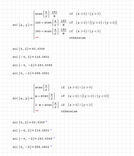

#4 Posted: 2023/6/12 08:41:14
1,443 likes in 2,935 posts.
Like this?

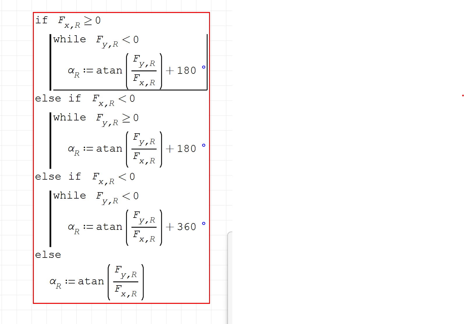

#6 Posted: 2023/6/12 17:24:24
m4xx4mx3
m4xx4mx3
0 likes in 5 posts.
Hello againe,
maybe this helps more.
So i took a screenshot.
as you see in this variant.
even if Fx,R and Fy,R are negative. The Loop "uses" the formular with +180° and i dont know why.
many thanks for your help and support
#7 Posted: 2023/6/12 17:33:14
1,355 likes in 2,271 posts.
I know that in some textbooks there are weird tables to compute the direction of a vector from it's components, because they use atan(y/x). Yet there are better options:
- two-argument form of atan(), in other programming languages, this is atan2()
- argument of a complex number
- dedicated SMath-function for conversion between rectangular and polar co-ordinates
atan2.sm (4.14 KiB) downloaded 1131 time(s).

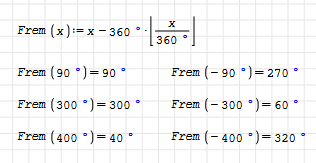

#8 Posted: 2023/6/13 00:17:32
1,123 likes in 1,795 posts.
even if Fx,R and Fy,R are negative. The Loop "uses" the formular with +180° and i dont know why. ...
Hi. What you have is not a loop, it's a series of nested if's. I'm sorry I can't express it in German. That from a conceptual point of view. From a practical point of view, you use the 'line' command in SMath, which simply returns the last value. You need to use a boolean operator, in this case 'and'. You can also use the functions of inequalities indicated in the figure.
As Martin says, physics books have very complicated ways to handle vectors in polar coordinates, which do nothing but complicate everything. To his list could be added the use of functions like this to restrict the value of the angle to a certain interval
notas.sm (11.9 KiB) downloaded 1114 time(s).

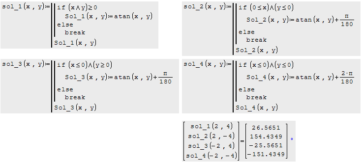

Piece wise works, but sanity check.
Cheers ...Jean.

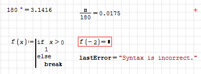

That's wrong, as usual. Conceptually, you don't use break without a while or a for. Otherwise you get an unnecessary error. And to finish embellishing it, you use the units wrong: the conversion between radians and sexagesimal degrees is wrong too.

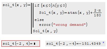

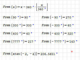

#10 Posted: 2023/6/13 12:38:02
... make it convivial.
atan(-2,-4)=-153.4349 'deg ... so, what's the point to add 2*π/180 to get -151.4349 'deg? Just try to learn something about radians and degrees. The expected value, if the intention is to restrict the angle at the interval 0 ≤ phi < 360 is -153.4349 'deg + 360 'deg = 206.5651 'deg
#11 Posted: 2023/6/13 16:59:38
... Add something in radian. ...
So, you don't make (again) a mistake with units. You just shows how to add "something in radian" like 2*π/180 = 2 deg instead the value provided by the user of 360 deg, and π/180 = 1 deg instead 180 deg. Good to know. Excellent example of handling random constants in programming. No one could be confused with that judicious choice of values. "sostenella y no enmendalla"

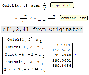

#13 Posted: 2023/6/14 07:43:09
... generalized algo style command line.
#14 Posted: 2023/6/14 10:23:20
Jean, it seems you keep getting things mixed up. If you took some time to analyze things you might see that the "Originator" (I guess it's m4xx4mx3) uses atan(Fy/Fx), and Martin uses atan(Y;X) or arg(X+ iY) to get the angle of the vector of components (X,Y) ...
Thus, the correct angle of the vector with components (4,2) is 26.5651°, and not 63.4349° as you seem to suggest. Again, "sostenella y no enmendalla".
overlord 2023/6/14 10:51:00, NDTM Amarasekera 2023/6/14 11:38:00
#15 Posted: 2023/6/14 11:52:32
The tangent of the slope angle of a line is rise over run, not vice versa. So you have to define Quick(x,y) as atan(y/x).
