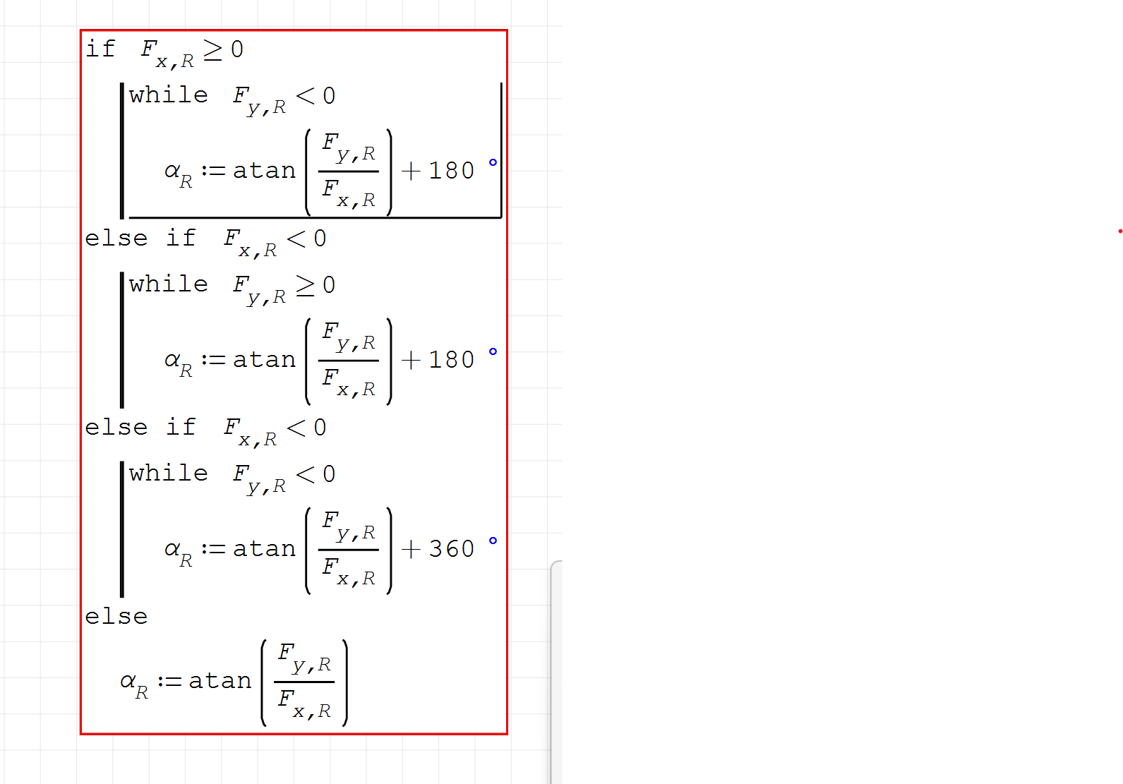

Hey, ich versuche eine If schleife zu schreiben, die von 2 Werten abhängt und je nachdem ob die Kombination "positiv Positiv" , "Positiv negativ" oder "Negativ negativ" ist soll ein anderer Wert mit einem andreen Beiwert berechnet werden...
MOD: Translated with DeepL
Hey, I'm trying to write an If loop that depends on 2 values and depending on whether the combination is "positive positive" , "positive negative" or "negative negative" a different value with a different coefficient should be calculated....

#2 Posted: 6/11/2023 3:39:23 PM
1,139 likes in 1,805 posts.
Hi. While loops never stop, since the criterion to stop them, if it is met the first time, will always be met by not modifying the condition that caused it to be executed. Perhaps what you require is simply nesting if conditions.

#5 Posted: 6/12/2023 4:54:16 PM
m4xx4mx3
m4xx4mx3
0 likes in 5 posts.
Since i don't understand how i can ad my SMath Solver I try to explain it more.
I have a Task. The first stepps are allready done.
My last step is:
Lets say i have
X:10
and Y:6.
I got a Formular to solve a angle:
a°=atan(x/y)
BUT if x or y is Negative my formular is:
a°=atan(x/y)+180°
and if x and y is negative my formular is:
a°=atan(x/y)+360°
In conclusion my problem is i don't understand how to say
as soon as 1 of these conditions are suffused --> solve the formular for a° and end the loop.
Like
IF X & Y is positive solve:
a°=atan(x/y)
IF X is positive and Y is negative solve:
a°=atan(x/y)+180°
IF X is negative and Y is positive solve:
a°=atan(x/y)+180°
IF X & Y is negative solve:
a°=atan(x/y)+360°
I hope you underdstand me and can help me.
Sorry for my bad english
thanks in advance
I tried your advice with 2 IF in once but i don't undersand how to "end/close" the loop.

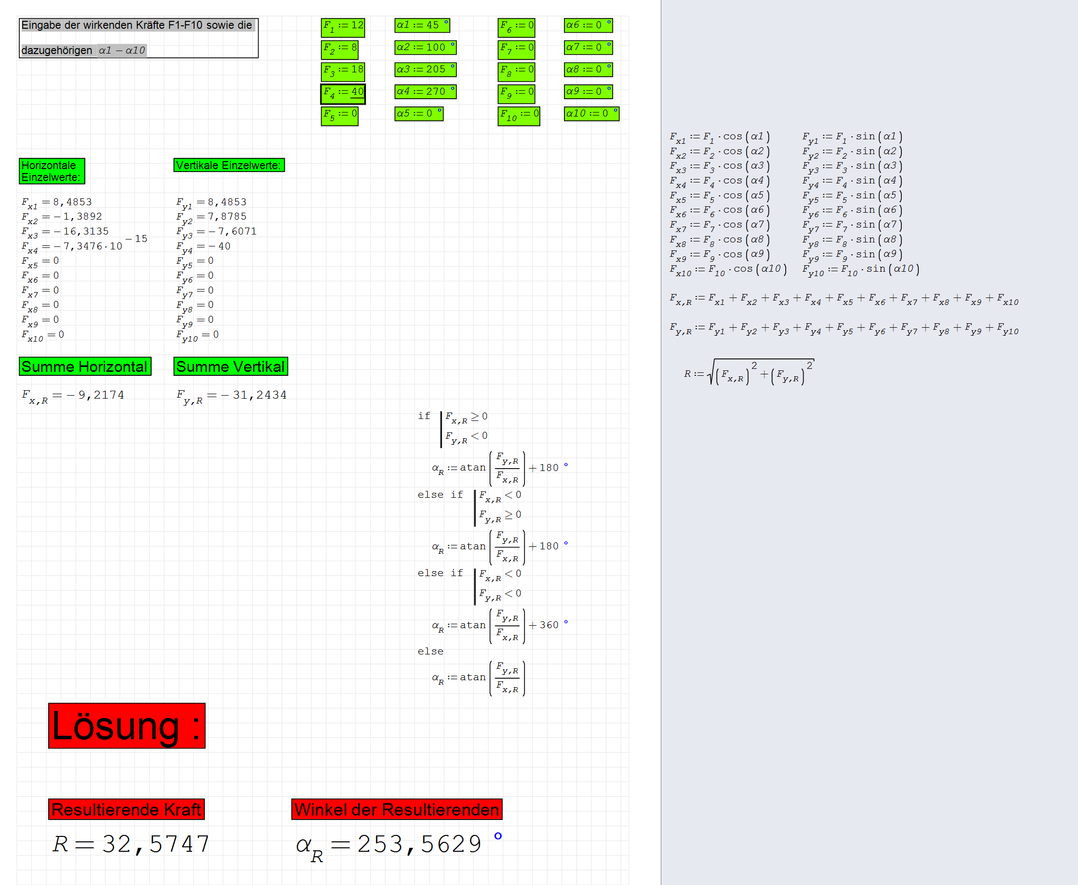

#6 Posted: 6/12/2023 5:24:24 PM
m4xx4mx3
m4xx4mx3
0 likes in 5 posts.
Hello againe,
maybe this helps more.
So i took a screenshot.
as you see in this variant.
even if Fx,R and Fy,R are negative. The Loop "uses" the formular with +180° and i dont know why.
many thanks for your help and support

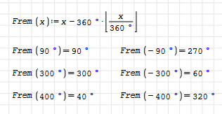

Hi. What you have is not a loop, it's a series of nested if's. I'm sorry I can't express it in German. That from a conceptual point of view. From a practical point of view, you use the 'line' command in SMath, which simply returns the last value. You need to use a boolean operator, in this case 'and'. You can also use the functions of inequalities indicated in the figure.
As Martin says, physics books have very complicated ways to handle vectors in polar coordinates, which do nothing but complicate everything. To his list could be added the use of functions like this to restrict the value of the angle to a certain interval
notas.sm (11.9 KiB) downloaded 1278 time(s).

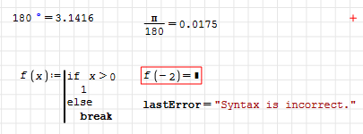

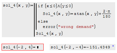

#9 Posted: 6/13/2023 12:22:46 AM
I hope you understand the project and can help.
Piece wise works, but sanity check.
Cheers ...Jean.
That's wrong, as usual. Conceptually, you don't use break without a while or a for. Otherwise you get an unnecessary error. And to finish embellishing it, you use the units wrong: the conversion between radians and sexagesimal degrees is wrong too.

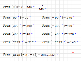

Вячеслав Мезенцев 6/13/2023 3:07:00 AM
#10 Posted: 6/13/2023 12:38:02 PM
... make it convivial.
atan(-2,-4)=-153.4349 'deg ... so, what's the point to add 2*π/180 to get -151.4349 'deg? Just try to learn something about radians and degrees. The expected value, if the intention is to restrict the angle at the interval 0 ≤ phi < 360 is -153.4349 'deg + 360 'deg = 206.5651 'deg

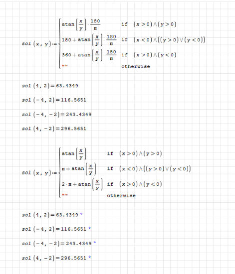

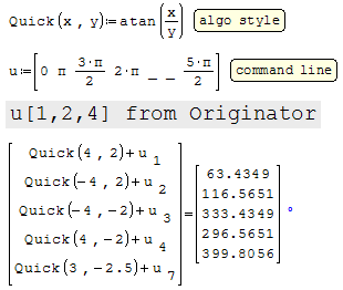

#13 Posted: 6/14/2023 7:43:09 AM
... generalized algo style command line.
#14 Posted: 6/14/2023 10:23:20 AM
Jean, it seems you keep getting things mixed up. If you took some time to analyze things you might see that the "Originator" (I guess it's m4xx4mx3) uses atan(Fy/Fx), and Martin uses atan(Y;X) or arg(X+ iY) to get the angle of the vector of components (X,Y) ...
Thus, the correct angle of the vector with components (4,2) is 26.5651°, and not 63.4349° as you seem to suggest. Again, "sostenella y no enmendalla".
overlord 6/14/2023 10:51:00 AM, NDTM Amarasekera 6/14/2023 11:38:00 AM
#15 Posted: 6/14/2023 11:52:32 AM
1,361 likes in 2,275 posts.
The tangent of the slope angle of a line is rise over run, not vice versa. So you have to define Quick(x,y) as atan(y/x).
#16 Posted: 6/14/2023 12:44:05 PM
So, we are three idiots in there ... Carlos, Jean, Smath
as we have same atan(4,2)... 63.4349°
You confused yourself from Mathcad atan2(4,2) = 26.5651°
Revisit the Mathcad definitions & codes.
atan(4/2) = 63.4349°
