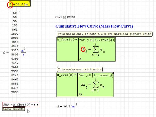

I get an error when using the same variable name in worksheet and inside the program loop.
Why do I get this?
In many earlier SS versions (can't remember versions) it worked perfect
Assignment Error with Units in Program Loop.sm (7.64 KiB) downloaded 1031 time(s).

#2 Posted: 2018/4/14 08:51:03
1,443 likes in 2,935 posts.
look here

Thanks Davide. I got it.
#4 Posted: 2018/4/14 10:45:49
... added the note wrt scalar Σ
Assignment Error with Units in Program Loop[1].sm (15.84 KiB) downloaded 826 time(s).
