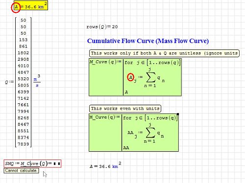

I get an error when using the same variable name in worksheet and inside the program loop.
Why do I get this?
In many earlier SS versions (can't remember versions) it worked perfect
Assignment Error with Units in Program Loop.sm (7.64 KiB) downloaded 1219 time(s).

look here

... added the note wrt scalar Σ
Assignment Error with Units in Program Loop[1].sm (15.84 KiB) downloaded 1006 time(s).
