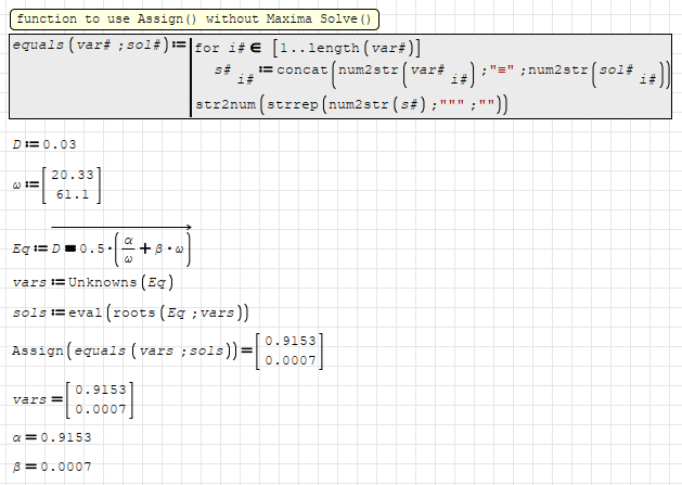

You can use roots() for your function. And a vectorize() can simplify it.
However, to use Assign() you will need this function to merge vars and solutions.
Assign_without_Maxima Solve().sm (7.36 KiB) downloaded 1138 time(s).
Mo 2022/4/5 22:22:00

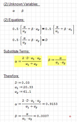

Greetings,
Another approach would be to use some elbow grease, you can substitute terms by hand and solve for 𝛼 and 𝛽:
Keypress (You can copy/paste the following into your worksheet):
α:{2*D*ω.1*ω.2}/{ω.1+ω.2}
β:α/{ω.1*ω.2}
*NOTE: ω.1 and ω.2 shown above are variables with subscript, they are not vectors ω[1 and ω[2; You should be able to substitute ω.1 for ω[1 if that serves your purposes.
- Kenny Lemens, P.E.
Mo 2022/4/6 11:57:00

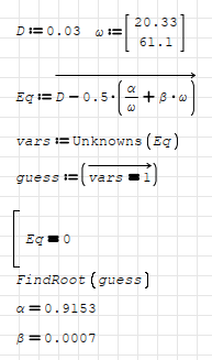

#10 Posted: 2022/4/7 18:19:34
598 likes in 1,380 posts.
I think this is the most sophisticated method of my way.
It can get unknowns from equation, solve them.
In the end assigns numerical values to unknowns.
You don't need to define alpha or beta or any variable.
All process is automatic.
mathblock_v2.sm (5.19 KiB) downloaded 1137 time(s).
There is also this way for guess define.
This is good, but for a system of linear equations(our case), the guess can be arbitrary.

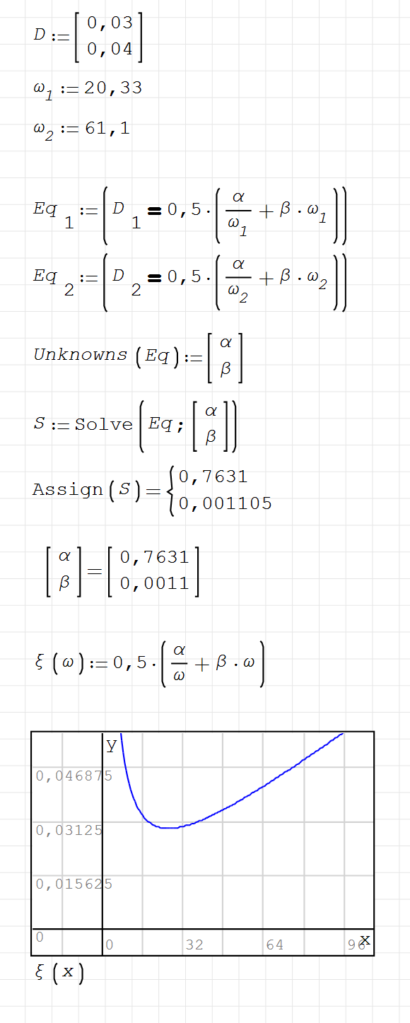

And finally a version with Solve() and list injection region:
mathblock_Solve.sm (4.86 KiB) downloaded 1097 time(s).
sergio 2022/4/9 04:48:00

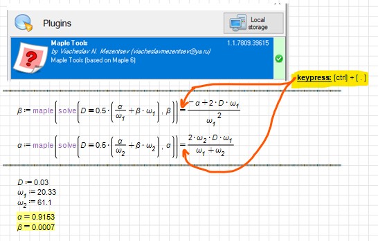

Greetings,
If plugins are considered, you can also consider the use of Maple:
In the image I posted, the 'equal sign' shown on those two equations are actually symbolic equals; keypress: [ctrl] + [.] instead of keypress [=].
Kenny Lemens, P.E.

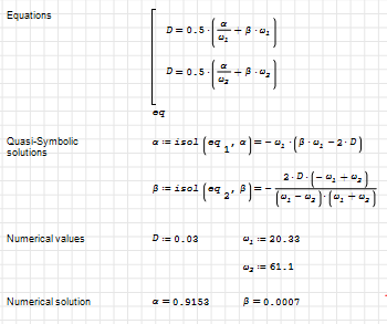

Hi. The isol solution, using only the Mathcad block plugin.
isol_example.sm (68.13 KiB) downloaded 1081 time(s).
isol_example.pdf (34.57 KiB) downloaded 598 time(s).
sergio 2022/4/12 05:01:00
