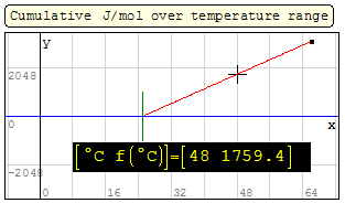

Hi. Try this:

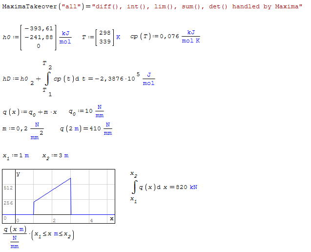

1,308 likes in 2,221 posts.
Maxima can handle integrals with units. Yet the restriction applies that the integration variable must be undefined.
int_issue_Kr_units.sm (10.14 KiB) downloaded 607 time(s).

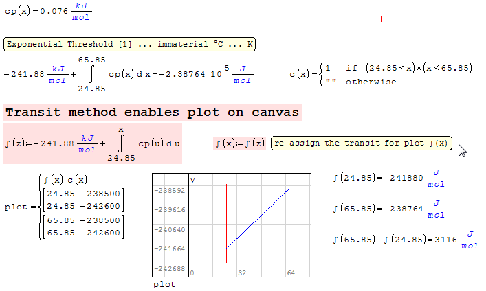

#7 Posted: 2019/4/1 22:49:00
Native Smath does it in much greater elegance.
int_issue [Transit Method].sm (9.39 KiB) downloaded 477 time(s).

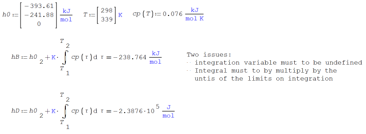

#8 Posted: 2019/4/2 09:14:40
Refreshed version managed from annoying units
Integral 0000000 Transit-Units.sm (23.78 KiB) downloaded 583 time(s).
