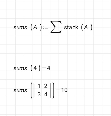

#2 Posted: 2022/4/18 09:50:44
1,443 likes in 2,935 posts.

#5 Posted: 2022/4/18 10:22:36
You're welcome
Note that using the stack approach you don't need the zero
